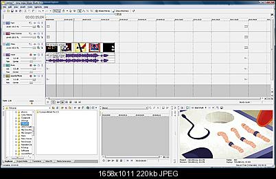

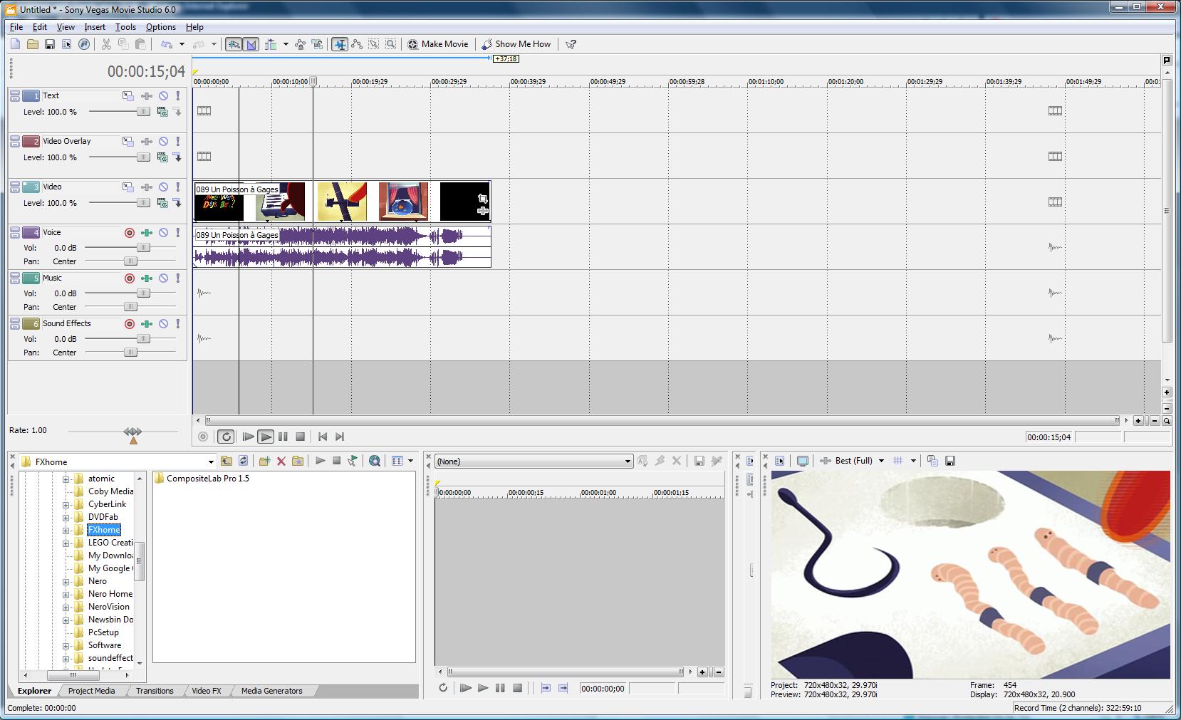

    You could try Vegas Movie Studio (you can download and try out the demo) It's a linear timeline editor that's easy to use, if you play with it you may be able to get things back in synch.
