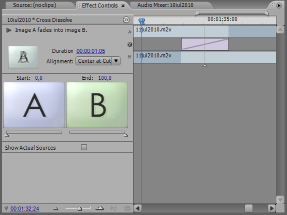

  1. after splitting and trimming a clip in premiere cs3 timeline, I ended up with alot of clips, but in edit points without triming, audio transition and video transitions aren't working. The only solution that I know of is to trim at least the number of frames that these transitions occupy, but is there a short and efficient way to trim at many edit points by a given number of frames ? There is Trim Monitor wich makes the trimming process this much more precise, but it trims just the video, leaving audio untouched...

    Here I can move the placement of the transition visually, but how can I overlap two clips by the exact duration of a transition ?

    EDIT: Aha! I noticed something from the OP's screen shot. Poorly placed transition! The transition should be between the tail of one clip and the head of the next. (Or am I just not seeing a file name for the next clip?)
