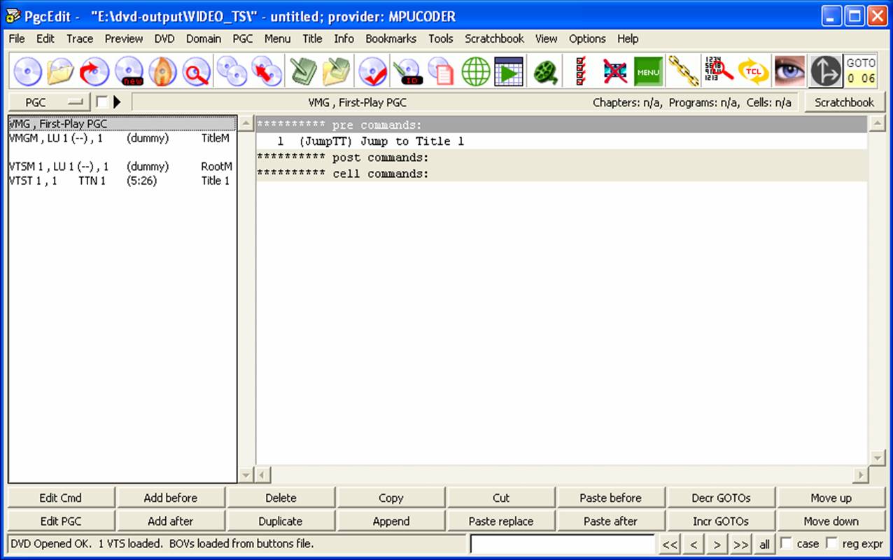

    I've managed to mux all the files (and the new subtitles) by using all softwares separately: Pgcdemux for demuxing, SubToSup for converting dylz's sub to sup, to be able to use them with Muxman, Muxman to mux all files and VobBlanker to restore the original DVD menus... but: first, as I tried to replace and I've opened the VTS_01_01.ifo from the Muxman output directory, I observed that there is only a VTS_01_0.ifo file (not VTS_01_01.ifo), so I selected it (I don't know if this difference in the name is relevant); second, I've selected a complete new folder as output (is it correct? should I copy the resulted files somwhere else at the end?); third, after 2 warnings messages from BobBlanker which said that "There are some audio attribute differences in stream 1 and 2", probably caused by the fact that I might have been changed the order of the audio streams, I confirmed to "correct the destination IFOs". After that I've hit "Process!!". I have attached the log file from VobBlanker. As I finally launched PgcEdit and opened the new created DVD, I see listed just a few informations and a 5 minutes movie... (please see attached screenshot).
    I'm sure I've done something wrong - probably at the VobBlanker stage, because if I play separately the VOBs from the Muxman output (I used VLC player for that), I can select and activate also the new added english subtitle!
    Could you guide me in the right direction to finish my new authored DVD?

  24. When muxing with Muxman, you forgot to load the Celltimes.txt:
    VTS 01: Replacing PGC 01 by E:\dvd-output\VIDEO_TS\VTS_01_0.IFO
    Cells to be replaced =17.
    Cells in replacing VOB=1
    To get your chapters back (and the whole movie, as you can see from the included pic), go File->Import Chapter and load the Celltimes.txt PGCDemux gave you.
    Also, when doing the 'Replace' step, open the original retail DVD, highlight the movie to be replaced so that it appears in the lower window, highlight it in the lower window, hit 'Replace' to the right, and scroll to the Muxman authored one.
    Also, I don't know if you did this or not, but if you have a single SUP file and the movie is 16:9, that SUP file has to be loaded twice in Muxman, once for Wide and then again for LB. That'll get rid of the red warning message.

    I've finally got it, thanks to your support!
    I think one of the most important thing is to work organized: the best is to create from the beginning separate folders for different stages of the files, as I could read in another post. For example, you can create the folders: "original", "demuxed", "remuxed", "authored" and save your files in the corresponding ones - this will avoid a lot of troubles and mistakes (experienced myself).
