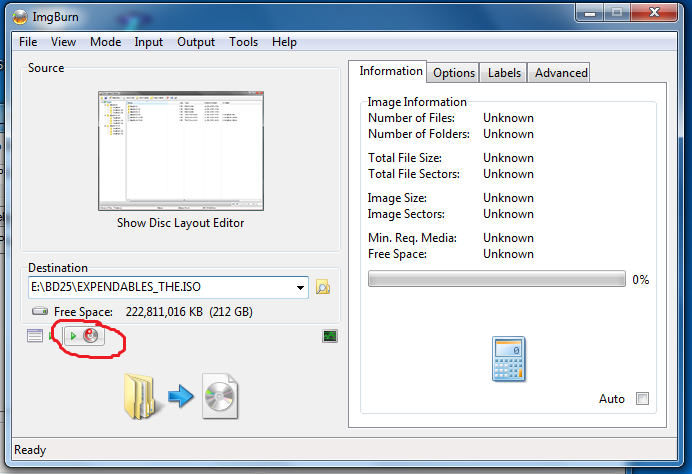

  2. Change the settings in imgburn:
    Click on the red highlight and it changes imgburn so that it will build an iso file instead of burning to a disc.
  3. Yeah, here's what the author says in the Doom9 thread:
    Quote:
    Originally Posted by thegdog
    Also, is there a way to have it just write an ISO file instead of burning it directly to disc? That way I could test it out before burning.
    This is an option you need to set in ImgBurn. Something like 'Build' rather than 'Write' in the menu bar.
