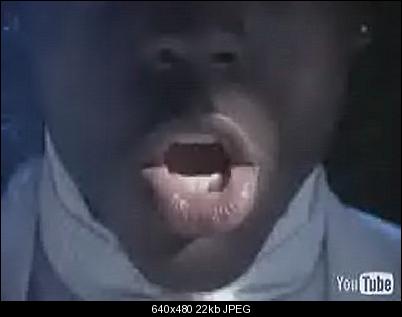

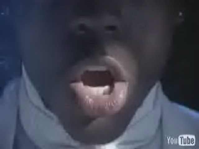

    here is my csi super deblocking (and logo remover...) filter
    before
    after
  4. That deblocking worked really well. It even removed the logo!
    Nice. A pity it only works if the source comes from a low res black and white security camera and the person is being reflected in the eye of a dog at the back of the frame under a full moon. Otherwise, great filter.
