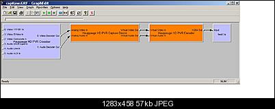

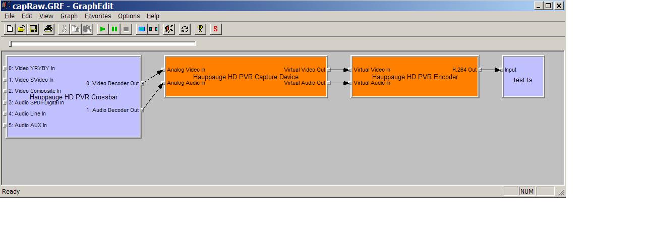

    My original topic was about deciding between 2 units (Hauppauge or Avermedia) but it was always with the intention of building a functional computer based PVR.
    Now that I've purchased the Hauppauge I've been concentrating on learning the available tools to design as close to a single-touch pvr as possible.
    So far this is what I've done but even these things will end up being modified and simplified where possible
    1) I've been using the graph found on Arogan's site. This is a better picture of it. His copy was kind of blurry
    It might be nice to add a preview to the graph but so far haven't found any working filters

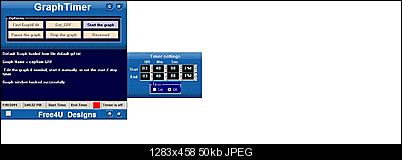

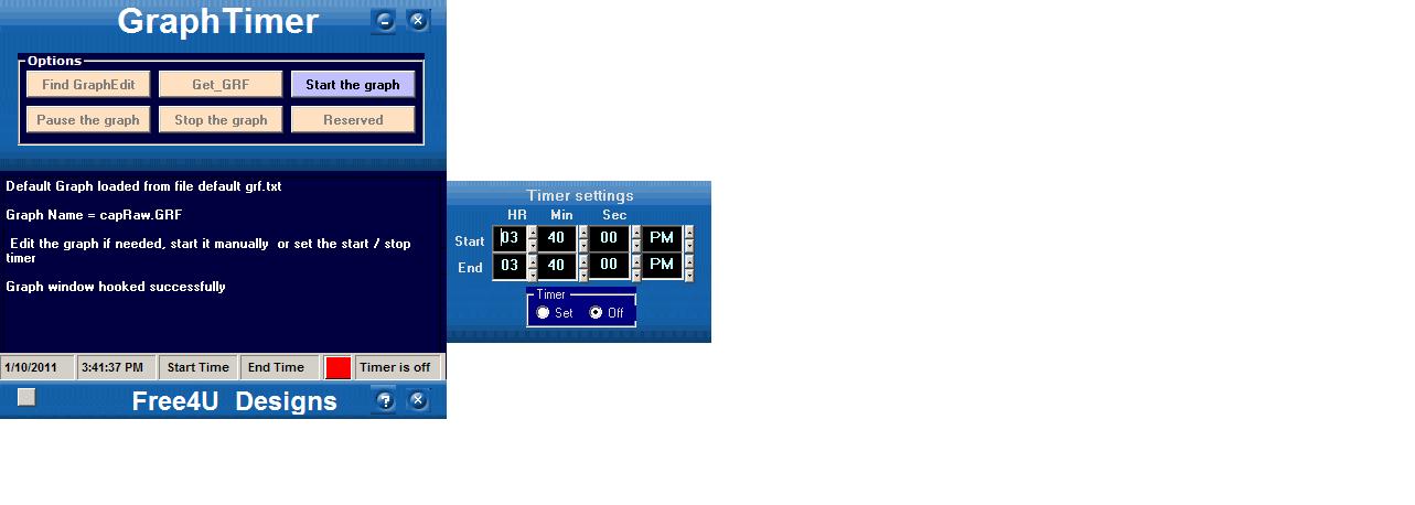

    2) I've written a small VB6 graphedt controller program (using findwindow by Caption) to start and stop the graph based on a simple single use timer (it's a work in progress). It saves the user defined path / location of graphedt and a default .grf in 2 text files and loads them at startup. The plan is to add a multi-timer function similar to WinTV but likely without the ir function unless I find a lot of free time. Right now it's just for testing. It also renames the static file name from the graph output to add the Date and Time so that the next time the graph is run it doesn't overwrite the previous file.
    Once the gui is loaded the graph can be started right away even if the timer is used for stopping or it can be started and stopped from the timer.
