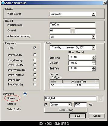

    I notice that the Avermedia scheduler lets you preset a split on file size during capture and continue on until the end time. Does the Wintv scheduler do that? It doesn't show that option in the Hauppauge guide. It might come in handy when writing to a fat32 drive so as not to go over the 4gb limit or to capture raw video files that will fit on a sl dvd disc.
    There's not much to do but then I can't do much anyway.
  10. I don't think Arcsoft Capture Module supports segmented capture. Though I've never tried it on a FAT formatted drive.
  11. Member SHS's Avatar
    Oct 2000
    Vinita, Oklahoma
    Don't ever use that option segmented belive me it bad idea
    It looks like a feature of the Avermedia scheduler only. It may not work in a direct manual capture.

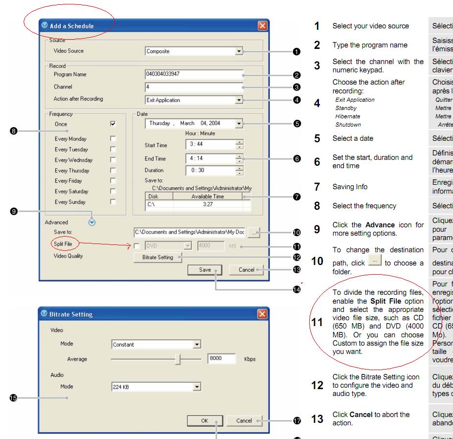

    My first impression is that the scheduler overlays the Arcsoft capture module and controls the file breaks. I'm guessing that if the Hauppauge has that function it would be part of the WinTV scheduler. I checked the pdf guide images to see if it shows a split function but it doesn't. I was wondering if the version of the guide I have is out of date.

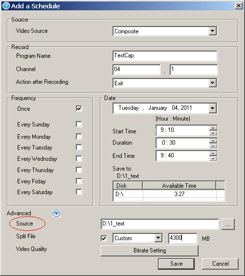

    Even though I don't have the device, I was able to d/l and install the scheduler for testing. On further thought I'm wondering if the split occurs after the fact. The fact they call the file "source" in the advanced settings has me wondering.
