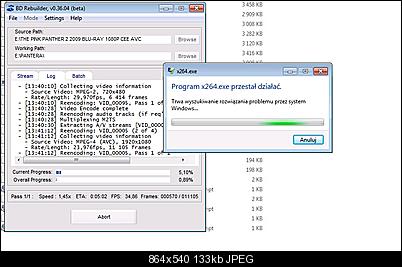

    codec setting didnt helped this is mine problem as u can see on this picture it happen imiediately after starting reencoding most problems i had with VC-1 codec when i was doin Fast and Furious 4 [2009] u can also see fps yes its fast coz its I7 processor . I got also other one PC where everything is fine but i didnt bought new PC with I7 for still using old PC there is is just C2D.

    this Retring is due this closing down of BDRebuilder. Right now i have 2 version with rebuilder one from PC wich is still working [C2D processor] and this new one BD Rebuilder is working ok but this X264 is just closing down do i need to remove something from registry or remove some other aplication aka power dvd?

  11. You haven't answered the question as to how the wrong version of X264 got into your BDRB folder. And the latest BDRB is 37.01, you should try that. X264 has been updated three times since the version of BDRB you're using.
    Anyway, I doubt the problem is your configuration, assuming you don't have a codec pack installed (do you?). However, when uninstalling and re-installing Haali, you should manually delete the Haali folder before re-install, as it does *not* uninstall cleanly. After re-install of ffdshow and Haali, you shouldn't have to change any settings if inspect.exe says your configuration is okay. You can also try using the internal LAVF decoder.
