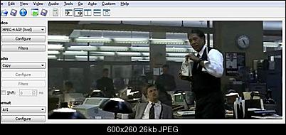

    Here u can see that the video isn't wide any more !!!
    can't find 16:9 option

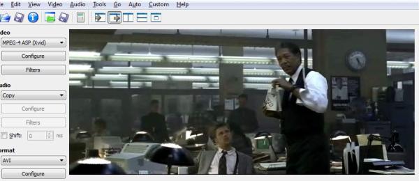

    In Avidemux, the aspect ratio is set in the Configure option under the Video menu on the left, but you may have to look around for it. For instance, for xvid, it's on the first page of the configure options, while for AVC, it's under "Configure"->"Options 1". I'm no Avidemux expert, so there may be other aspect options that I'm unaware of.
    As an alternative to setting the aspect ratio flag, you can just encode as square pixel (that's what I usually do these days; not all of my past media players have respected aspect flags).
    To use square pixel encoding for your particular movie, use Avidemux's crop filter to crop 72 pixels from the top, and 72 from the bottom, then use the resize filter to resize to 720 X 304 (for this particular 2.35:1 movie; use 720 X 400 for the more common 1.85:1 widescreen movies (adjust to taste, if desired)). That should get you pretty close to what you want (it's hard to tell exactly from your jpg). That will give you something like the picture below:
