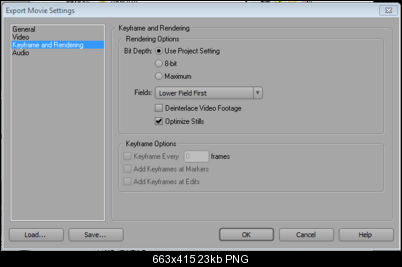

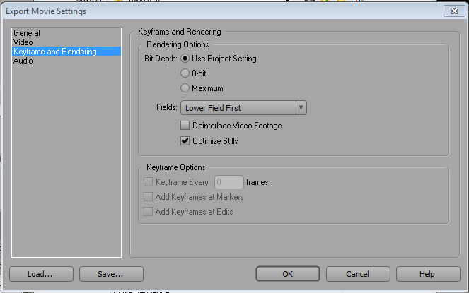

  1. I've edited an MPEG2 video in Premiere Pro CS3, but in the same window where I choose to export using DebugMode Frameserver plugin, there is a place called "Keyframe and Rendering", where the Fields option is set to "Lower Field First", but how do I know wich option is correct here: "(No Fields) Progressive Scan", "Upper Field First" or "Lower Field First" ?

  2. You have to determine what the original video was.
    use the same as whatever your asset and project settings were
    if it's interlaced, it's either top or lower field first . If pick the wrong one, it will be jerky (like forward-back-forward-back) , then you know it's the wrong one
    if it was progressive, choose progressive

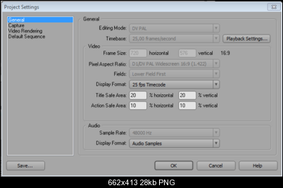

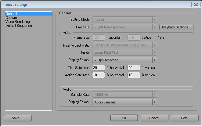

    after analysis with MeGUI, I know that the source mpeg2 is interlaced with upper field first, but in the project settings, fields is set to lower field first and it is greyed out, I can't change it to upper to correspond with the source. Are there any problems if source is upper ff, project is lower ff, and I export with upper ff ? What if I have progressive and interlaced sources mixed in the timeline, or a mixture of sources with different field dominance ?

  4. If you mix TFF, BFF , sections will become jerky , but mixing progressive and interlaced can be ok in an interlaced timeline. Ideally you should use the same format or convert everything to the same format
    you're using an older version of premiere, but you can set custom "desktop" settings (instead of a DV-PAL setting in the editing mode) which unlock everything for the settings. You may have to set it for the sequence settings or project settings. It's a bit different than the newer versions. DV is ALWAYS lower field first, that's why it's greyed out

    assuming megui's analyzer is correct (it's been wrong before), just set it top field first , and whatever you encode to , keep everything top field first
    It matters. If you get the wrong field order, it will play jerky. Premiere will not automatically fix anything

    after analysis with MeGUI, I know that the source mpeg2 is interlaced with upper field first, but in the project settings, fields is set to lower field first and it is greyed out...snip...
    [Attachment 4957 - Click to enlarge]
    It's greyout out because you can only change that when you create a Sequence.
    Change your preview to high quality and scrub your footage. If it shows no interlaced problems with the lower field order then the source must be getting decoded to FRAMES because FourCC:M2V isn't the native editing mode. It just happens that the Importer is getting the FIELD decode right. ( I have 2 cameras that it's around the wrong way so you're lucky).
    If it is decoing wrong the only way to fix it is the make a new Sequence with it set the UPPER and hope that Premiere doesn't screw it all up in the decode.
