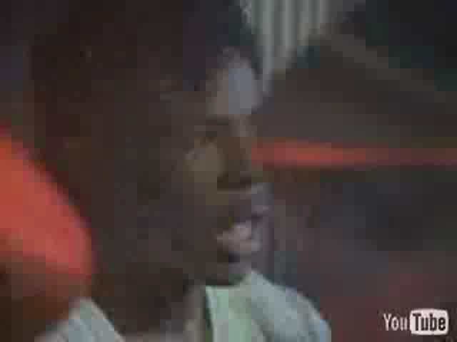

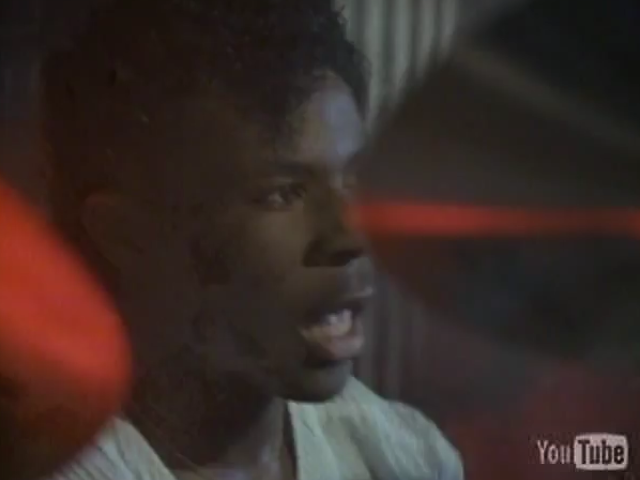

    here's a few seconds from the clip, using ffdshow deblock at 200% using mplayer algorithm
    notice the frames aren't 1:1 either - ie. directshow isn't frame accurate . This is another reason why you should use aviynth
    1st - original
    2nd - ffdshow deblock
    3rd - "CSI" method
