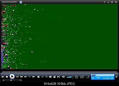

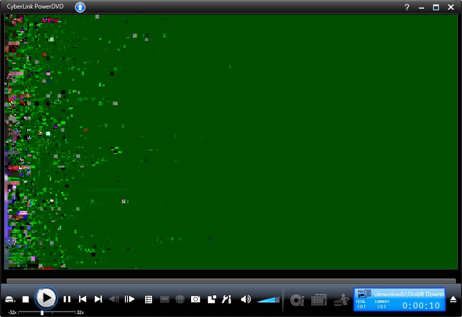

    I've got a transport stream from an HDTV broadcast and there seems to be a problem with it. The file plays fine in VLC Media Player but in PowerDVD I just get a green screen with a bit of fluffy picture at the edge and a black screen on WMP. Not tried any others.
    Here is the PowerDVD look
    That to me would suggest it's corrupt in some way, but if it was how would it play correctly in VLC? The proper video must be there somewhere. I've tried demuxing with several different tools, ran quickstream fix in VideoReDo and mpeg2repair but any demuxed/remuxed version is the same.
    Any ideas for fixing it or is it screwed?

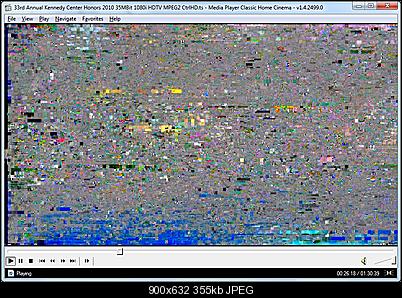

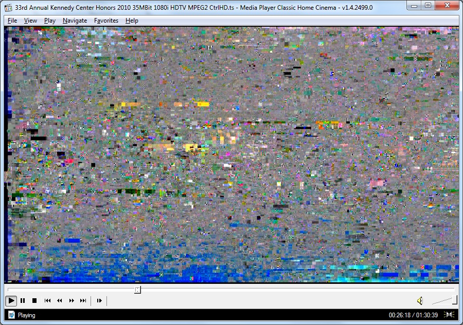

    There must be something different or wrong about this file though, I can play countless other very similar spec 1080i/MPEG2 streams in PowerDVD just fine. The only thing I saw video mediainfo was two closed caption streams in the video, but I removed them and still the same issue.
    Trid that Splash player posted above, same problem as Windows Media Player, audio but no picture, black screen. MPCHC was similar to PDVD:
    There is definitely something wrong with it. VLC seems to be the only program that'll play it. MPEG2Repair seems to think it's fine though:

  15. The problem is the 4:2:2 chroma subsampling. Not many MPEG 2 decoders can handle 4:2:2 chroma and I rarely see MPEG 2 video that uses it (normally they use 4:2:0). As poisondeathray points out, ffdshow works. And you already know VLC's internal MPEG 2 decoder works.
