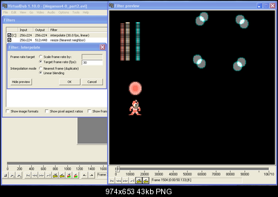

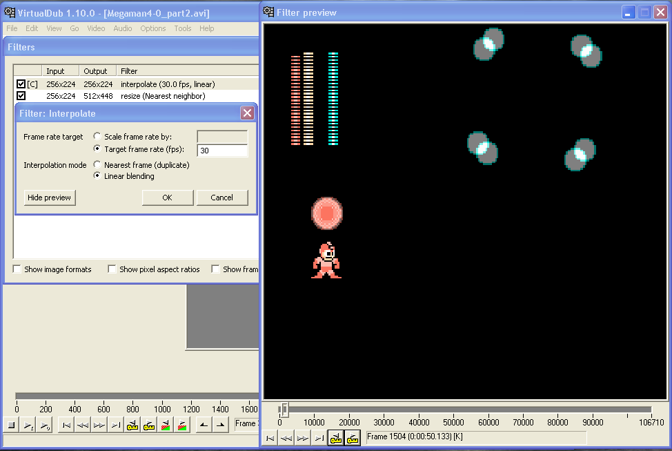

    Hello! as my name implies im valis77 from youtube and i was doing some testing regarding the interpolation. I use virtuadub to interpolate the video im using. Here is a screenshot of a video i did.
    Those static balls have double image which is good but i was wondering. If it's possible, can i make the double image closer together...not to close? Why im asking this im just trying to test stuff on youtube? Thanks for the help in advance.
  2. Originally Posted by valis77 View Post
    Those static balls have double image which is good...
    No, it's not. Purposely blending images without a good reason is almost never good.

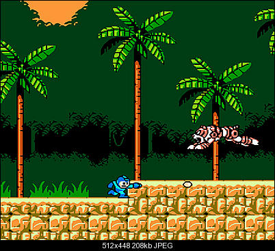

    Use NESTOPIA with H4qx filter and bilinear interpolation ON.
    Make your movie...Nestopia save AVI with all filters enable...Espetacular video quality.
    After this, loading in VD and resize.

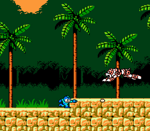

  9. Lone soldier Cauptain's Avatar
    Jan 2006
    Brazil
    Cauptain
    nestopia is not my thing i use fceux
    No problem.

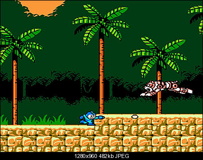

    Download PointSize.dll and save in AVISYNTH plugins folder.
    Export your AVi and make a AVS file lookslike this:
    AVISource("megaman4.avi", audio=true)
    Crop(32,0,-0,-0)
    ConvertToRGB32()
    hq4x()
    LanczosResize(512,448)
    or
    DirectShowSource("megaman4.avi", audio=true)
    Crop(32,0,-0,-0)
    ConvertToRGB32()
    hq4x()

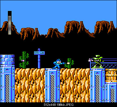

    Fceux video with my AVS config:

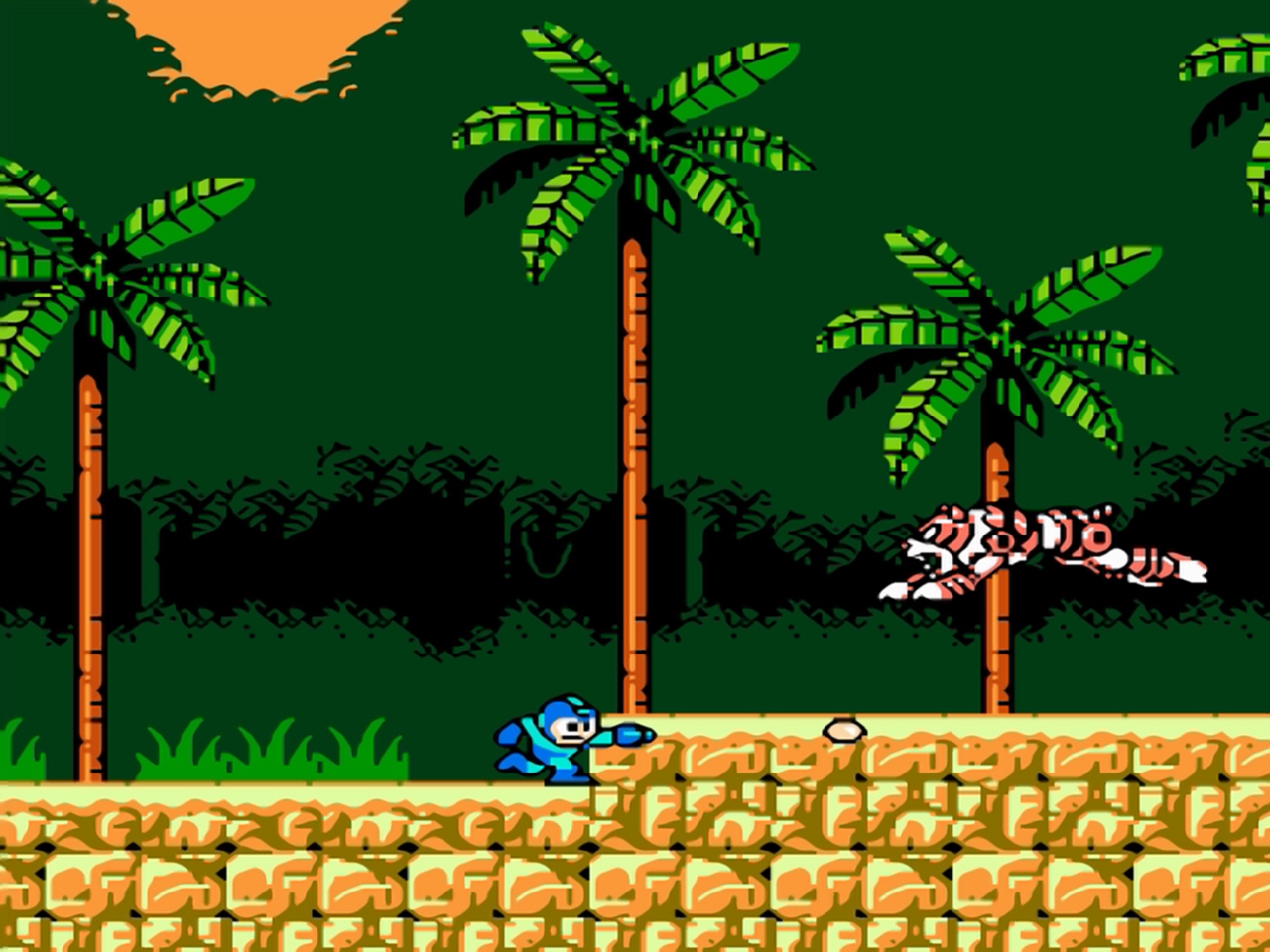

    Fceux video on 720p (4x3):

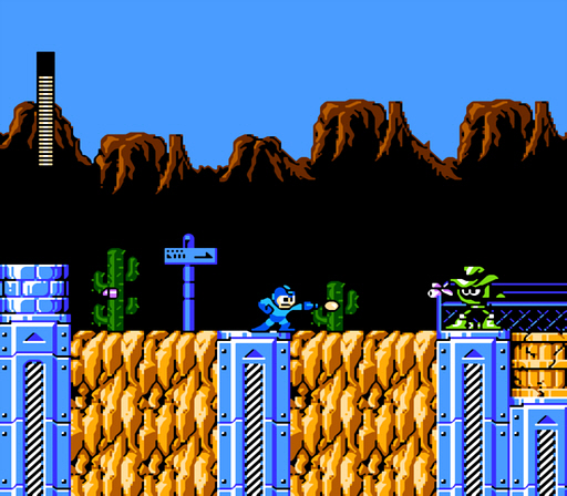

  11. Member valis77's Avatar
    Dec 2010
    is if i tell

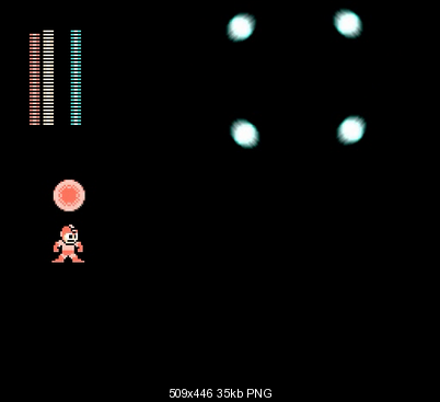

    Thanks to my friends longplays website they figures out how to achieve.
    This is how he did it. Much better!
    ffvideosource("C:\fs\interp\Megaman4-0_part2.avi")
    converttoyv12()
    super = MSuper()
    backward_vectors = MAnalyse(super, isb = true)
    forward_vectors = MAnalyse(super, isb = false)
    MFlowBlur(super, backward_vectors, forward_vectors, blur=70)
    selecteven()
