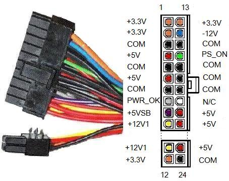

    The extra pins are there to add amps to the motherboard.
    Most allow you to split off the 4 newfangled pins.
    Image from : http://www.smps.us/20-to-24pin-atx.html

    The illustration shows the extra pins slotting to the side of the others.
    Some connectors have the extra pins slot in a vertical direction [20pin]^v[4pin] (sorry for my poor diagram)

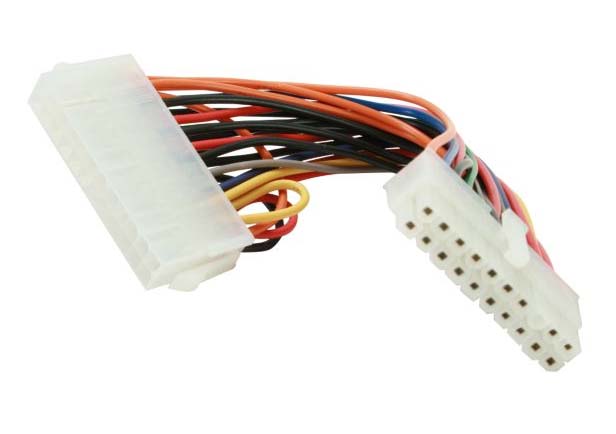

    I think he meant one of these...
    http://www.newegg.com/Product/Product.aspx?Item=N82E16812530004

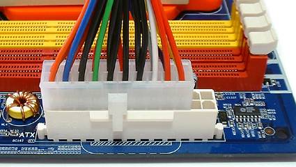

    You only need a adapter lead if there is no room for the overhead from the larger connector.
    If there is room you can just hang the extra pins off the connector.

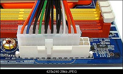

    The pins are keyed so it can (normally) fit only one way.

    But of course that is only advisable to do with a system which draws not so much power.
