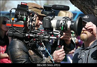

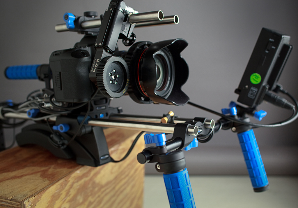

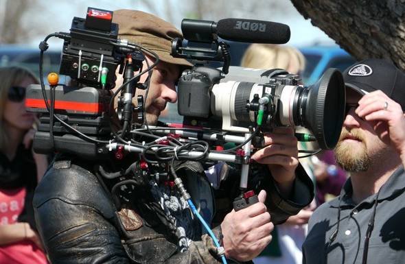

    Have you ever held a Canon 5D MkII (with lens) and think it is small? Ever see the suitcase with accessories? Also, this kind of cam needs a 20 lb. Bogen/Manfroto tripod. Not great for hand hold.
    DSLR's are an alternative but not a fully functioning camcorder. Also the AVCHD format is difficult to edit.
    So you want to go into the wedding video business? I suggest the 5D MkII be used for B roll.
    Rigged for B roll camcorder duty

    Fully Rigged with audio.
