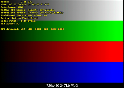

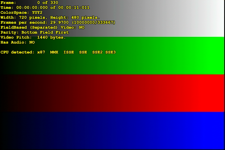

    Do you know how to use AviSynth? If so, open your video in AviSynth and use the Info() command to see what colorspace is coming out of the HFYU decoder:
    AviSource("filename.avi")
    Info()
    All capture cards first capture as YUV because that's what's in an analog video signal. Only if RGB is requested do they convert to RGB in the driver.

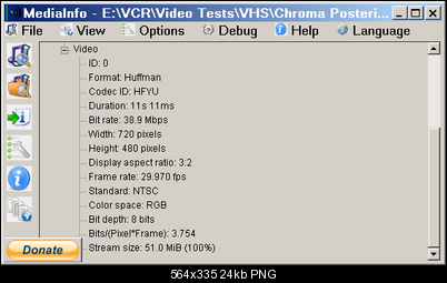

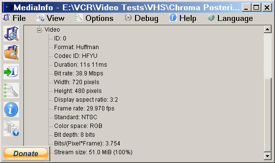

    I just took a look at what MediaInfo reports for HuffYUV encoded AVI files. It always seems to report RGB, even though the uncompressed frames coming out of the decoder are YUY2.

  7. Originally Posted by smartel View Post
    the point to my question is capturing RGB(via huffy) that bad ?? is it better than capturing mjpeg ?
    It depends. If the YUV video contains luma values outside the 16-235 range those sections will be crushed by the conversion to RGB. There will be no possibility of restoring detail in the very dark or very light areas. If your video doesn't have pixels outside that range conversion to RGB only causes a minor loss of precision. Much less of a problem than compression with a lossy codec like MJPEG (unless you're using a lossless MJPEG).
