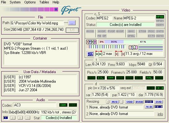

    I just ripped 6 DVDs full of 78 episodes of Pocoyo for my son(also editing out the opening intro piece for every one of them with MPEG-VCR) and need to batch encode them to Xvid with MP3 audio(for my Trekstor HDD player attached to my TV). Any recommendations on which software to use? I've encoded tons of clips but never had to do so many at one time. My usual software for single conversions is VDub, AviDemux and occasionally MainConcept Reference. I've also used WinFF to do some conversions for iPod/iPhone stuff for friends. My main concern is keeping the correct aspect ratio as the clips play. Black bars on my non-widescreen TV are perfectly fine(preferable actually) to me.
    Any of my preferred softwares provide me with a semi-painless opportunity?
