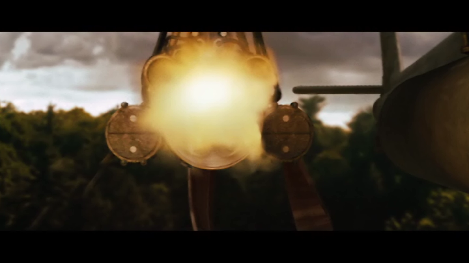

  11. That sample image was so discolored, distorted, and blurry I couldn't tell what it was at first. A simple BilinearResize (the least sharp resize filter in AviSynth) would be much better.
    Of course, your graphics card or HDTV probably does better than that so there's no point.
    That's frame 372 from the VOB sample by DgIndex/Mpeg2Source()/VirtualDub count.

  13. how could you did that in VDub? Any filter to know Frame Number?
    It gives you the frame number at the bottom. At least VDubMod does, and I assume VDub is the same.
    That's Original sample without any encoding - as is.
    Eh? The source is a 720x480 DVD, right? And your pic is 1920x1280 (and with bad aspect ratio) as encoded following that crappy script of yours, right?

  15. Originally Posted by Bonie81 View Post
    nice work.
    Not really. That was an example of the second worst upscaling method (worst would have been nearest neighbor).
    Then something is extremely wrong with your computer.
