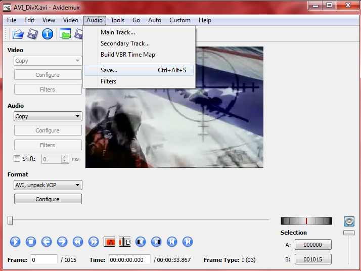

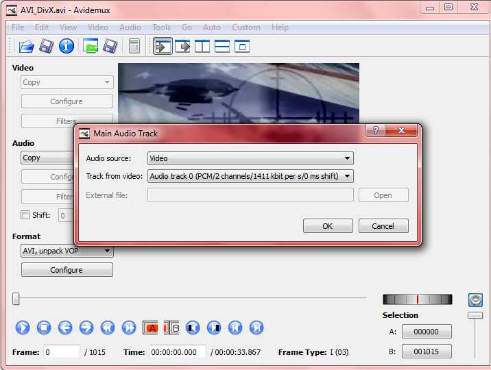

    its fairly simple with AviDemux...just open it up, load up the avi you want...click on the "audio" button at the top...click on "main track"....it should look like this
    then click n the "track from video" drop down box and choose the audio track u wanna save. Also notice the type of file in the box...this is .wav
    after that, click on the "audio" button again and click save...this time save it to where you want but be sure to add the file extension to the type of file it is...it wont do it for you...so mine would be...example.wav
    do this for all the tracks u wanna demux...doesnt take long
