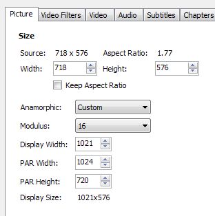

Have just been putting my incorrect video back in handbrake but whatever I do I cannot get the correct 1024 x 576 PAR settings to hope the TV will see the correct flags.
You can see from my attached picture that the display size is 1021 x 576 even though the PAR Dimensions are correct.
Do you think this will solve incompatibility if I reeocde like this please?

I don't know if Handbrake is going to set the AR flags in the video stream or just the header (I've never used the program). You need to find the x264 settings and specify the SAR there. You might try using an MP4 container instead of MKV. Mabye the TV will work better with that.
