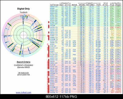

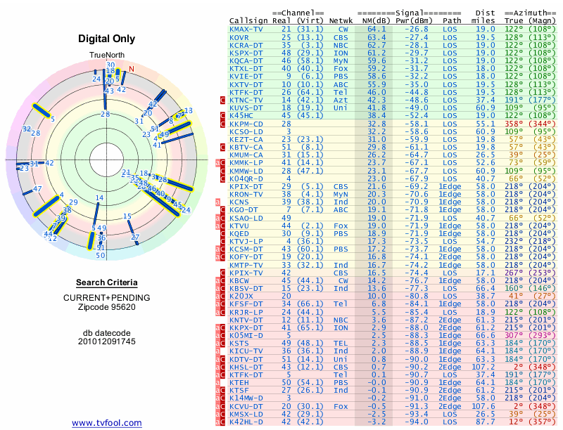

  13. Member edDV's Avatar
    Mar 2004
    Northern California, USA
    You are only 19 miles from the Walnut Grove towers. Direction is SE. You should have a strong signal there but Dixon-Fairfield are notorious for ground fog in winter months which attenuates TV signals. If the next door building is blocking your line of sight to that direction, you need height not a huge antenna. Here is your approximate TVFool plot (center is your 95620 post office).
    As I said above, KXTV (ABC) and KVIE (PBS) are on VHF so a UHF antenna won't see them. You need an antenna that covers both bands.
    I doubt in your situation that an amplifier will work well. You are in a strong signal area and receiving bounced multi-path signals not the more reliable direct beam. Amplifiers just allow more multi-path interference. Instead, you need to raise the antenna until it can receive the direct beam.

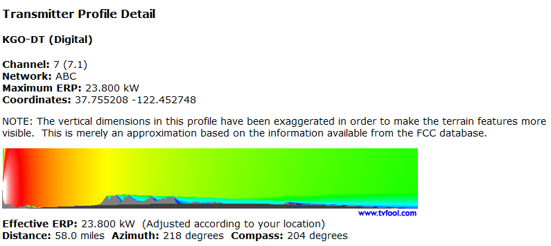

    In summer months you have a good shot to receive San Francisco stations to the southwest if you have a clear local view. Still 1Edge means there is a hill blocking in that direction but signals bend over hills to some extent. See an example here for KGO-TV 7 on the Sutro tower.
    This plot has your post office on the right edge of the graph. All Walnut Grove plots show no hills, just a clear path.
    (image snipped)
    My (powered, for what it's worth) antenna does handle both VHF and UHF... or at least, it claimed to, and has the extending rod antennas. I do get the channels if I shift the antenna - but, of course, I don't want to lose the other channels. (If only my TV had a signal strength meter, and/or allowed me to 'tune' to stations not detected during the channel scan...)
    I was afraid of that (that I was most likely receiving signals that have been bounced one or more times, such as between the two houses). As for the San Francisco stations... possibly. I've received 2, 4, 20 and 44 on odd occasions, most of them late on the weekends and usually in the summer. Out of those, channel 4 is the only one I'd really had to turn the antenna to a different direction, though.

    You need to isolate multi-path and find the direct signal from the towers. The two ways around that are use a directional antenna pointed to the towers and find a hole in the blockage (house next door). Best way to do that is to elevate the antenna. You are fortunate that all the desired stations are coming from one direction.
    Multi-path reflections vary with temperature and weather so will come and go.
    (image snipped)
    If you can find the direct beam, all stations will be solid.
    Multipath strength also varies by channel frequency so you need to keep aiming the antenna as conditions change during the day or when changing channels.

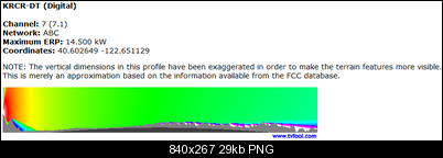

    Post your TVFool plot like the one above and I'll try to match you to an antenna. If you have a line of sight (LOS) to the transmitting towers and the towers are all in the same direction, then it should be possible.
    Imagine my plight. I can only reach for 2 edge (two distant ridges in the path) and 60 to 120 Miles distant. The closer stations are blocked by a nearby ridge. Still the 60 mile stations lock in year round while the 120 mile stations only come in during winter after the oak leaves fall. And yes the quality is better than cable/sat. Only VHF 7 and 9 work at 120 miles. Antenna aim needs to be exact (+/- 2 degrees)
    Each house needs a custom solution. My situation requires a back of house roof mount (not visible to street) shooting between two large oak trees. It helps that I'm at ~3,000ft elevation (above the towers) thus avoid ground weather.

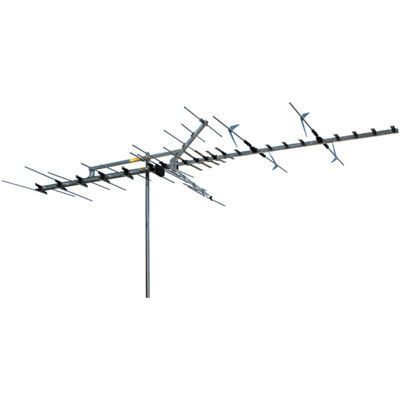

    Wineguard HD7697 (extremely directional) + Channel Master VHF/UHF mast mount pre-amplifier.

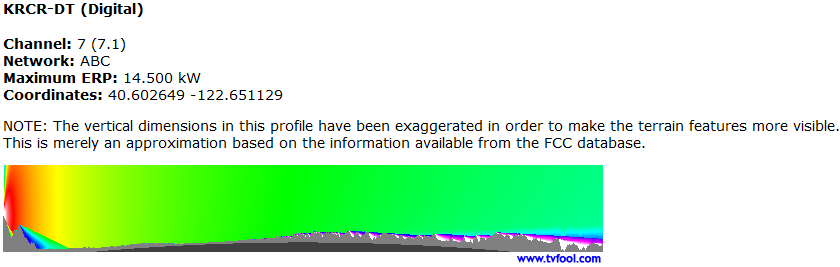

    Check out this 126 mile path to KRCR-7 Redding. The VHF signal bends over the two highest mountains in the path to reach me. The antenna + preamp need to produce 91 dB of gain to break through the noise. Fringe reception is very different from urban multi-path reception.
