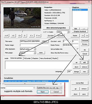

    just open Multiavchd..."add video file" and click on "properties"..you should see a tab called external subtitles...click on "add" and browse for the subs you wanna use...i'm pretty sure the subs will be an optional on/off setting and not embedded permanently.

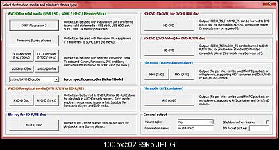

    after your done with what subs you want click ok then click on start and you'll see what formats Multiavchd can convert to
