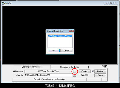

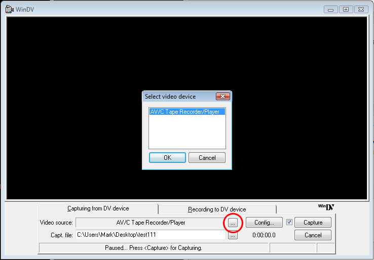

    That's where I'm confused - the "Microsoft DV Camera and VCR" option doesn't even exist for me when I click "..." (see image):Click image for larger version

    I'll look into Corel Video Studio, I'm afraid that I'd buy it and that won't work as well this is extremely frustrating. I have emailed Grass Valley support and posted about this on their forum as well.

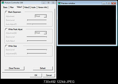

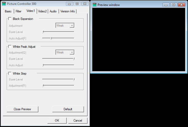

    Correct - it's set to "off", but Picture Controller still opens. The preview window is nothing but a black box, though:

    (screenshot taken with video running)

    Firstly - try the silver button on the top of the box to switch the input source analogue/digital
    if this does not work....
    1. turn off ADVC
    2. set switch to PC mode
    3. turn on ADVC
    4. Turn on Picture controller - hit the OK key (that will switch the input source in PC mode)
    5 Turn the Picture Controller back on and select the preview - you should now see a picture
    If you see a picture then there is no reason why WinDv will not work. The lack of picture is the issue not the program.

    Sep 2006
    Thanks again for your suggestions -
    The unit was always in Analog, but I tried Digital with the same results.
    I also tried the PC mode/picture controller 5 step process you've listed to no avail - still the same issue, a black screen. I suppose I'll see if I get a response on Grass Valley's site. Otherwise, I'm at a loss, here...
