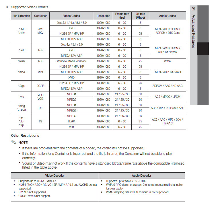

  1. I could really use some expert assistance. My TV refuses to play some MKV files, displaying an unhelpful codec error message. I've used VLC to examine the codecs of the files that do work and the ones that don't, but as far as I can tell there's no difference. How should I go about spotting the difference between the files?
    [Attachment 4811 - Click to enlarge]
    Last edited by MrFriendly; 22nd Dec 2010 at 12:37. Reason: Added screenshot of supported formats (page 31 of the manual)

  7. I've attached the relevant page of the manual when I first posted. It lists a whole bunch of things that I don't understand. Apart from that, container, codec and bitrate are acceptable. There is no file size restriction listed, but I've played far larger files than the ones that have failed to play, so that can't be the issue.
    Thank you for the tip about MediaInfo's tree view. Would you mind helping me track down what the manual says the TV won't handle? I don't know what to look for.
    Supports up to H.264, Level 4.1
    I think this may be the problem with at least one file. One file that fails has "Format profile High@L5.1", while one file that works has "Format profile High@4.1". Do you think "level" in the manual is what MediaInfo calls "format profile" or am I on the wrong track?
    I have absolutely no idea what these mean:
    H.264 FMO / ASO / RS, VC1 SP / MP / AP L4 and AVCHD are not supported.
    GMC 2 over is not support.
