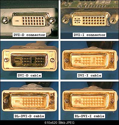

    The DVI-I has many pins for various connections. The HDMI adapter (or cable) only connects to the DVI-D single link pins.
    It gets more complicated for "dual link" which no HDTV cares about.

  8. Member edDV's Avatar
    Mar 2004
    Northern California, USA
    Originally Posted by Stealth3si View Post
    [Attachment 4799 - Click to enlarge]
    I don't get it.
    I'm using a monitor, not an HDTV.
    First, no HDTV set allows dual link in. They are limited to HDMI v1.4max spec.
    A dual link computer monitor can exceed 1920x1080 but if the source is less, that would require upscale which is lossy.
    Define your source.
    http://www.kiva.org/about

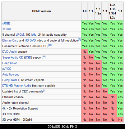

    You read the monitor spec sheet to determine HDMI version support and supported resolutions. These are usually in the manual.
    Most computer monitors that support resolutions higher than 1920x1080 use DVI-D dual link. HDMI v1.3, v.1.4 are rarely supported by display cards or computer monitors. You must read the specs for supported modes (e.g. xvYCC, 3D).
    Note that a monitor's HDMI version number does not mean all modes possible for that version are supported. You need to see spec for each feature.
    http://en.wikipedia.org/wiki/HDMI

    Nov 2005
    There is no advantage connecting a 6800 GT to a VH242 using HDMI. Normal connection is DVI-D to DVI-D. HDMI v1.1 and DVI-D single link are electrically identical.
    But I can still use an HDMI 1.3 cable to connect an HDMI v1.1 LCD monitor to the back of another video card's HDMI 1.3 female output and it will work as normal?
  26. Member edDV's Avatar
    Mar 2004
    Yes. All the HDMI cables have 19 pins/wires and work at v1.1 level.
