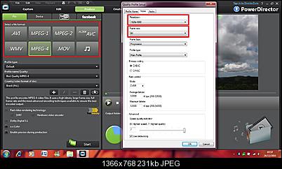

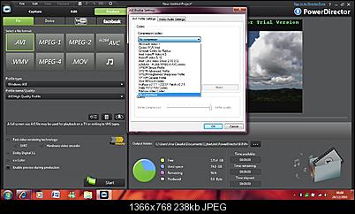

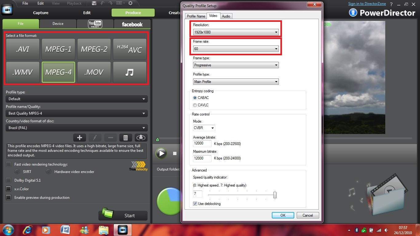

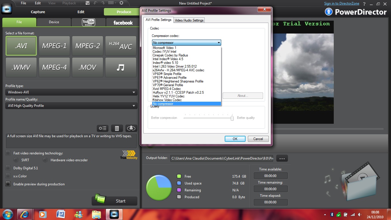

    Sure you can. x264vfw will integrate into most NLE's like vegas, premiere for example. (It will show up as an option under "AVI" export). There are 2 versions of it , and the menus are a bit different but you can experiment
    This is a great suggestion. Works ok and turns up on the export / encode menus of the video editors / converters. Spares me all that hassle of frameserving or intermediate lossless files.
    Now, as human beings are never satisfied, there is this very tempting box that says "Extra command line (for advanced users)". Is there some site where I can learn what command lines I can use and how to understand the various variables that the command line gives me access to? Never really tried command lines in anything except one or 2 situations when trying out linux, but then I was just copying from somewhere else, not really understanding it.

    Use Power Director 9. Easy learn, efficient and impressive.
    Tried the 64 bit version. Definitely not convinced. Regardless of the merits of the editor itself, when one gets to the export phase (called PRODUCE on PD9) one is faced with a closed system with a handfull of choices and which does not recognize the codecs that are installed on the computer. What's the use of a good video editor if in the end you are not allowed to freely choose the codecs, the width and height and the framerate?
    For me work...

    [QUOTE=Cauptain;2042774]
    For me work...
    Let me clarify. Everything's fixed. I can't choose 720 x 400 (or 416), for instance, which actually is something I use a lot. No XviD. I installed x264vfw and it doesn't show up on the compression choices, etc. Basically, it's a closed system. If you're ok with the options that are there, fine, if you aren't, the whole thing becomes useless. Which actually is a pity, why ruin an otherwise good editor by limiting the output options?
  27. Member
    Dec 2010
    Portugal
    For me work...
    Ooops, just noticed that you do have all the options. I don't. Are you using the 64 bit version or the 32 bit version? I've been reading some posts on Powerdirector forums and maybe the closed system is a problem of the 64 bit version. Not sure as I haven't tried the 32 bit version. Which one are you using?
