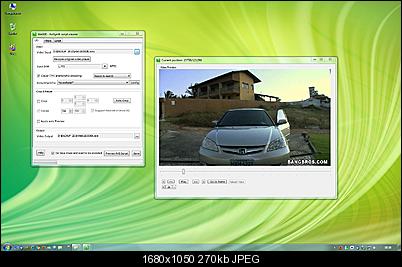

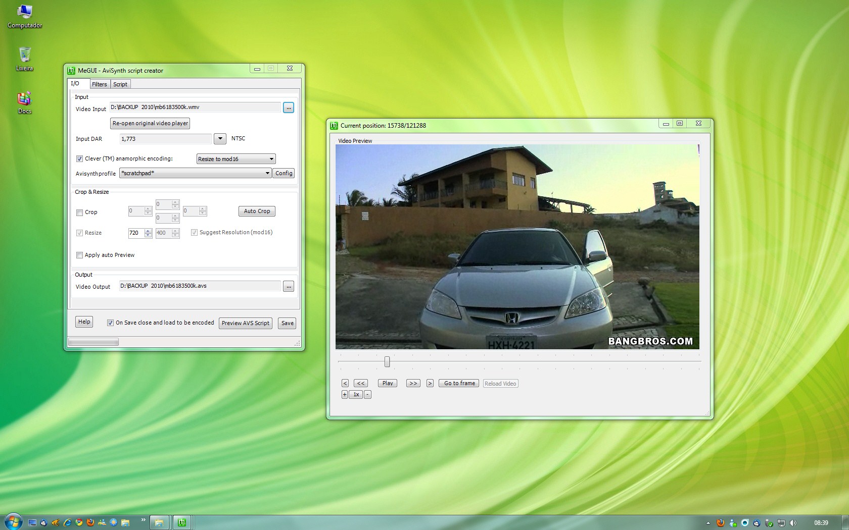

    Many thanks to you all for those suggestions. I should perhaps have mentioned at the start that most of the files I'm putting to disk are .wmv. I've installed MEGUI and, disappointingly, wmv is not among the supported file types. I'll now try xmediarecode and report back...
    WMV working normal in MEGUI...strange.
    You opening WMV files in AVS script creator??

    For all file type, open before with AVS Script Creator or make your AVS file. For AVI, try DirectShowSource if Avisource not working.
