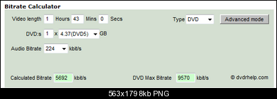

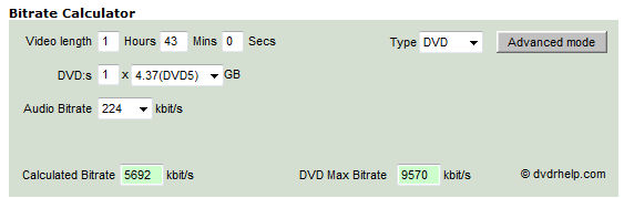

    * From the bit rate calculator you will see the required average bit rate for 1hr 43 minutes is 5692 Kbps video, 224 Kbps audio or less.

  9. Originally Posted by edDV View Post
    Your properties window shows you are encoding at near highest quality (~1 hour per layer) which is good as it gets. Yet this has nothing to do with your level shifts issue. We suspect the problem is just the way you are monitoring on the computer. Go ahead and burn a test DVD to see if you have a levels problem when playing the DVD to a TV from a DVD player.
    Originally Posted by jolu View Post
    Ok I'll go ahead and try that. What are your recommendations as far as software goes for burning a .ts file? I was able to trim it down to fit on a regular dvd disc.
    You have at least four options.
    1. Split the program into two single layer DVDR discs (cheapest)
    2. Burn full program to a dual layer DVDR disc.
    3. Encode at a lower bit rate to fit the full program to a single layer but at lower quality*.
    4. Edit the program down to fit 66 miniutes (4.3 GB).
    Did you say what software you were using to edit?
    You will need DVD authoring software to make a formal DVD. This software will convert (multiplex) MPeg2 files to a VIDEO_TS folder. Then, use a program like ImgBurn to burn the disc.
    [Attachment 4798 - Click to enlarge]
    I just burnt one of the videos on a DVD and it didn't turn out as dark as I thought it would. Its still noticeably darker than the original but, not as bad as it was when viewing it on the PC. Its only on certain parts so, I think we can just suck it up.
