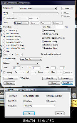

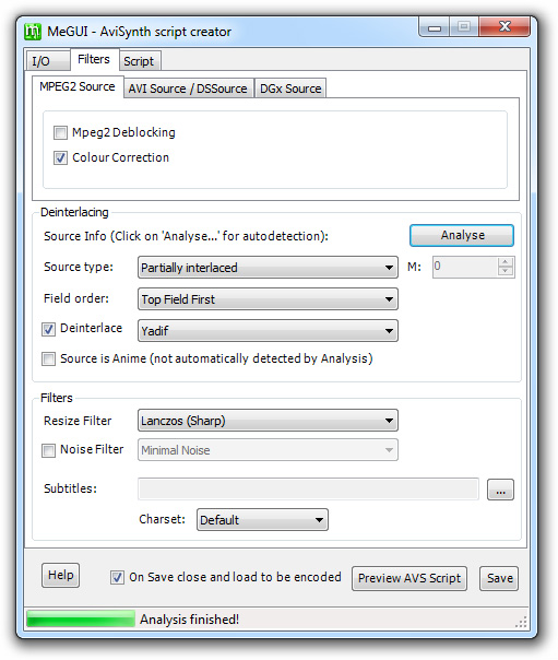

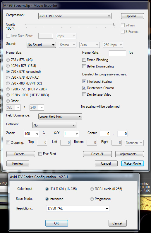

  7. The source is a recording from a camcorder that records straight into DVD PAL format and writes it on miniDVD discs. I then demux the AC3 and M2V streams using DVD Decrypter, so that I can decode the AC3 stream into WAV using azid_P4 and then convert M2V to QuickTime with MPEG Streamclip using a DV codec. And finally, import the .mov and .wav into NLE for editing.
    Here's what MeGUI says about the M2V after analysis:
    and here are the settings for converting to dv:
    if I don't check "Deinterlace Video" option, the video has a ~2px black bar at the bottom, or at the top in case I change "Field dominance" to "Upper Field First"
    when I import the .mov file in NLE, it asks about it's field dominance, I check "bottom field", and after it imports it, it shows a small black bar at the bottom of all frames
