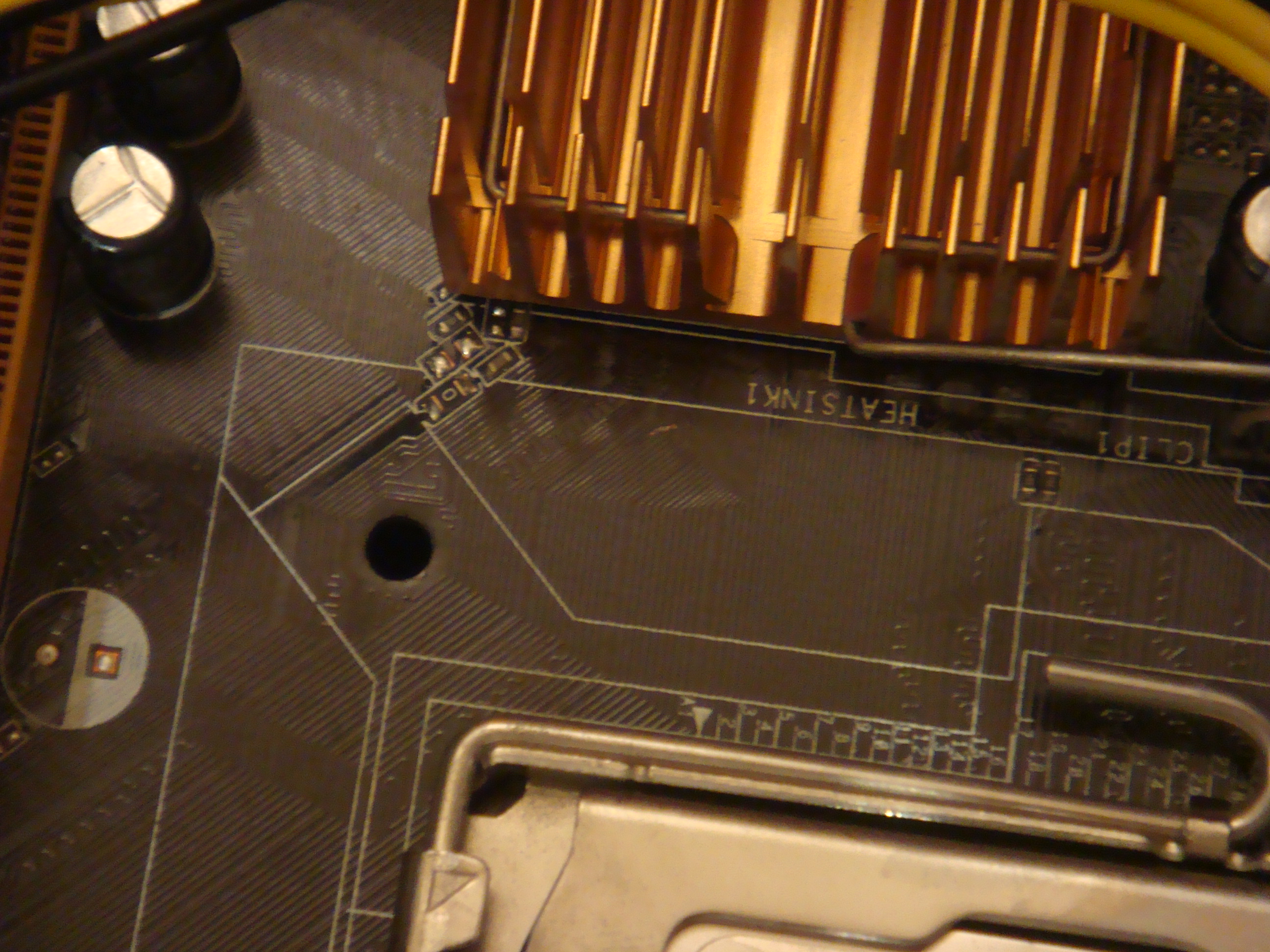

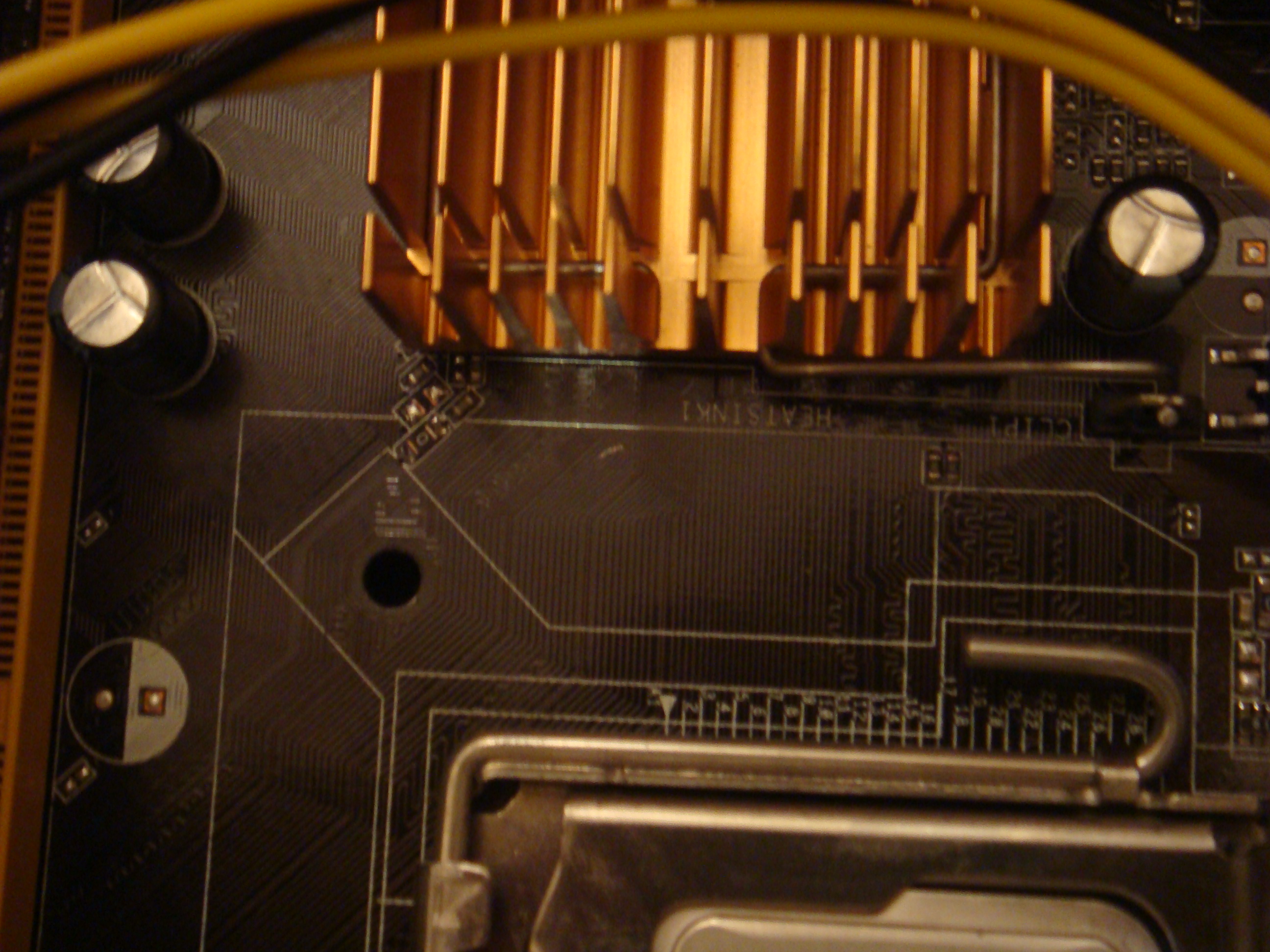

    Have added pics showing scratch etc just along from where it says heatsink on pic 1

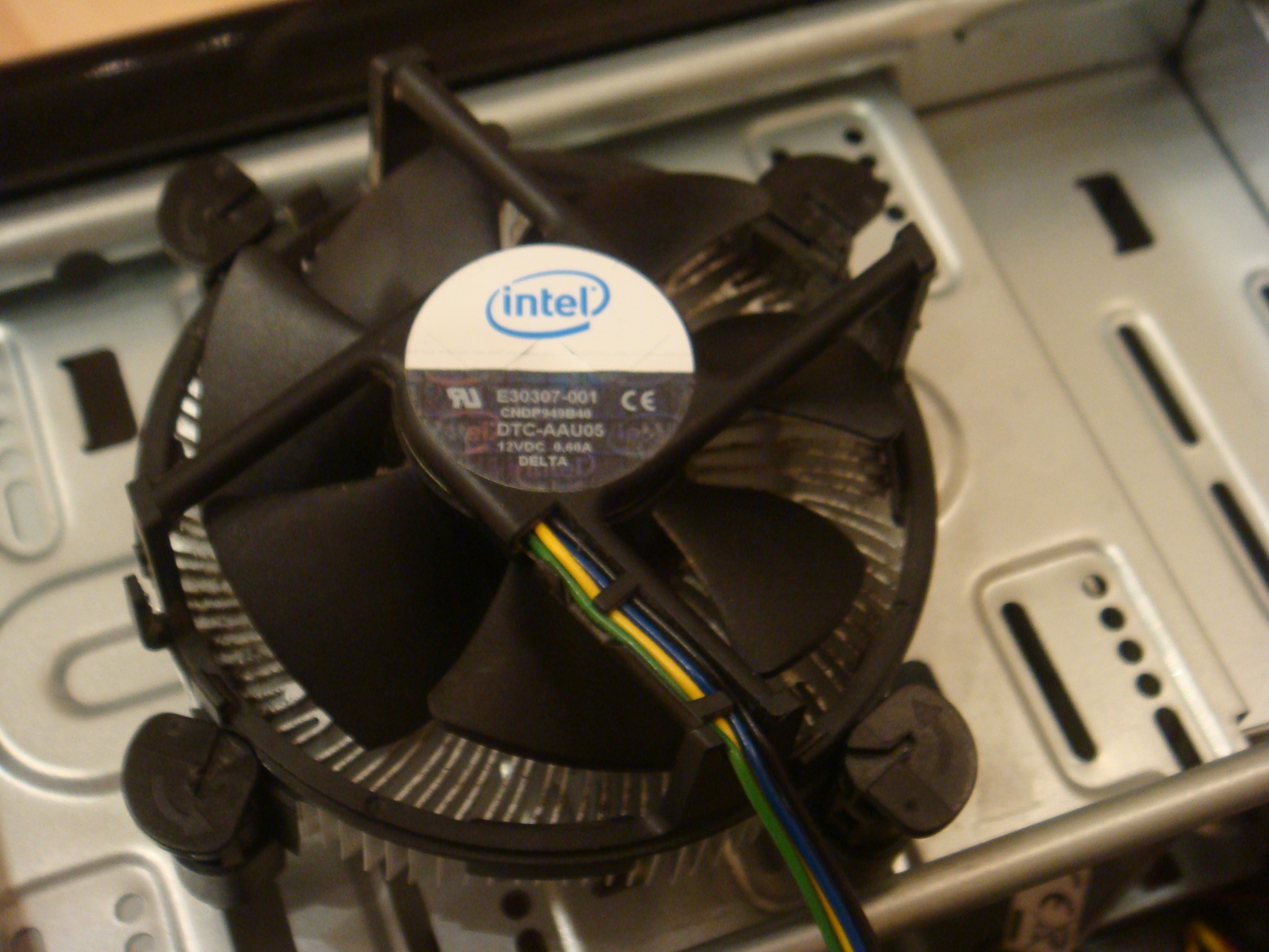

    Thanks for the pictures, that helps quite a bit. That scratch may have been fatal for the motherboard. It's hard to tell from the pics, but if any of the circuit board traces are cut, it's done for. No MB beeps are a very bad sign.
    I did the same thing a few years ago trying to pry down the clip of a AMD cooler. Brand new MB, destroyed. I scratched the area by the RAM.
    On the top of your CPU, you can see the remains of your thermal compound. You cannot reuse it. You need to clean off the old compound on the CPU and cooler with something like 99% isopropyl alcohol (Rubbing alcohol) and apply a new layer of compound, usually about equivalent to the thickness of about two or three pages of magazine paper. Here's one guide: http://www.techpowerup.com/printarticle.php?id=134
    If you've damaged those plastic push pins, which I imagine you have, they need to be replaced or the cooler needs to be replaced. That appears to be a stock cooler, so easy enough.
    The small 'peg' at the bottom of the push pin expands the pin and holds the cooler to the motherboard. That has to be retracted for the pin to go through the MB mount hole. And often the pin has to be squeezed a bit before it will go through. The pins should be very easy to insert in the MB holes. But lots of times they get easily damaged and need to be replaced or very carefully reused. I take the MB out of the case to do this. Some info on push pin usage: http://forums.anandtech.com/showthread.php?t=2047683

    I would probably just get a new MB cooler. There are many that will work with that MB. You might want to study how those pins work. They have a small arrow on the top to show locking position and need to be unlocked and the peg retracted before inserting or removing and relocked afterwards. If you have a computer repair shop around, you might get a new stock cooler for free. Many experienced builders don't use the stock cooler, so they have them laying around unused. A new cooler will usually have the thermal compound already applied.

    Could you send us a link to a new MB cooler same one or diffeerent that i could buy or is it poss to buy spare pegs?
    Would this one work for me?

    I am not familiar with intel coolers but if the fixing pins are not damaged they should be re-useable . Redwudz advice is good . Make sure that there is headroom in the case for any cooler you choose . You could find the edge of a dvd drive in the way .

    Problem is 1 of the pins is damaged and i don't think it will hold down properly.
    Anyone know of one i can use?

    Could you recommend a cooler for my motherboard?
    Is it possible to use one which doesn't have these plastic pegs?

    For anybody to make a recommendation they need to know which Intel CPU you have. I use a stock cooler, however when I looked into aftermarket coolers for a system I built last year, the specs listed which CPU sockets work with them, and sometimes a rated wattage.
    Also, you would need to measure the cooler and fan you have and try to get something about the same size. Many aftermarket coolers are taller and/or wider than a typical stock cooler, and then you need to figure out if there will be enough clearance between them and other items in your case or on the motherboard.
