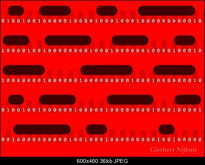

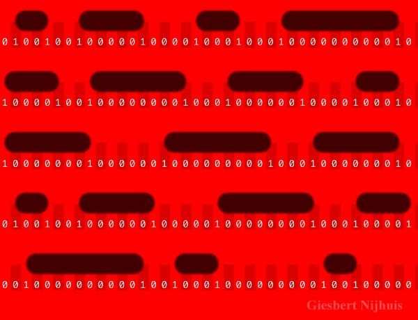

    If you mean to print out the binary of the pits and lands on a DVD disc, you better have a lot of paper handy.
    Here's a bit of info about CDs that is similar: http://www.laesieworks.com/digicom/Storage_CD.html

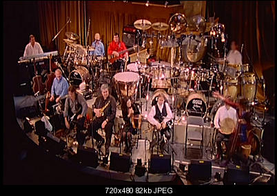

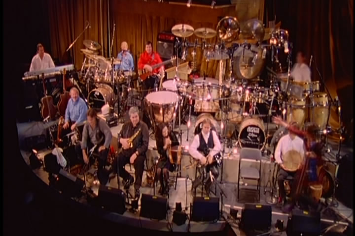

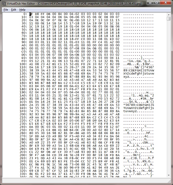

    You might try this: I opened a VOB from a DVD in MPC-HC and paused the video, then used 'File>Save Image' to grab one frame of MPEG-2 video to make a .jpg:

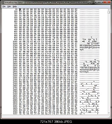

    Then I opened the .jpg in Virtual Dub (Or VD Mod) Hex Editor, 'Tools>Hex Editor'. That may not be a true representation of the actual frame data, but it is representative of what a hex editor can do. There are about 14,600 lines of data from that image. If you figure about a two hour video, 7200 seconds X 29.97 frames per second, that would be about 2,157,884 frames of video. Times 14,600 would give you a rough idea of how much data is there, at least looking at it from the hex editor.
    This is line 190 (w) converted to binary. (I think. I haven't worked with binary in quite a while. Hex is a lot more convenient for large amounts of data.)
    0010 0100 0100 0011 0100 0111 0101 0100 - 0100 0000 0001 0010 01110111 0000 0001 0010

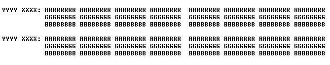

  12. If I was hired to create the program I'd suggest something like this:
    Where YYYY is a four digit row number, XXXX is a four digit column number, and the RRRRRRRR, GGGGGGGG, BBBBBBBB are 8 columns of 8 digit binary values of each pixel. That would make it easy to locate any particular pixel.

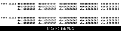

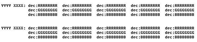

    Or:
    where dec is the three digit decimal value of each sub-pixel.

    Redwudz -- that is awesome. Now, is the DVD coded in hex, or is that just how the hex editor deals with the data? Binary remains my goal...
    Hex, binary, octal, decimal -- are all just ways if displaying numbers. For example the following four representations are all equivalent:
    binary: 10100101
    octal: 245
    hex: A5
    decimal: 165
    roman: CLXV
    upside down apples: QQQQQQQQQQQQQQQQQQQQQQQQQQQQQQQQQQQQQQQQQQQQQQQQQQ QQQQQQQQQQQQQQQQQQQQQQQQQQQQQQQQQQQQQQQQQQQQQQQQQQ QQQQQQQQQQQQQQQQQQQQQQQQQQQQQQQQQQQQQQQQQQQQQQQQQQ QQQQQQQQQQQQQQQ
