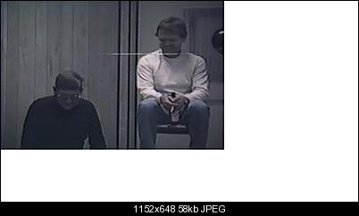

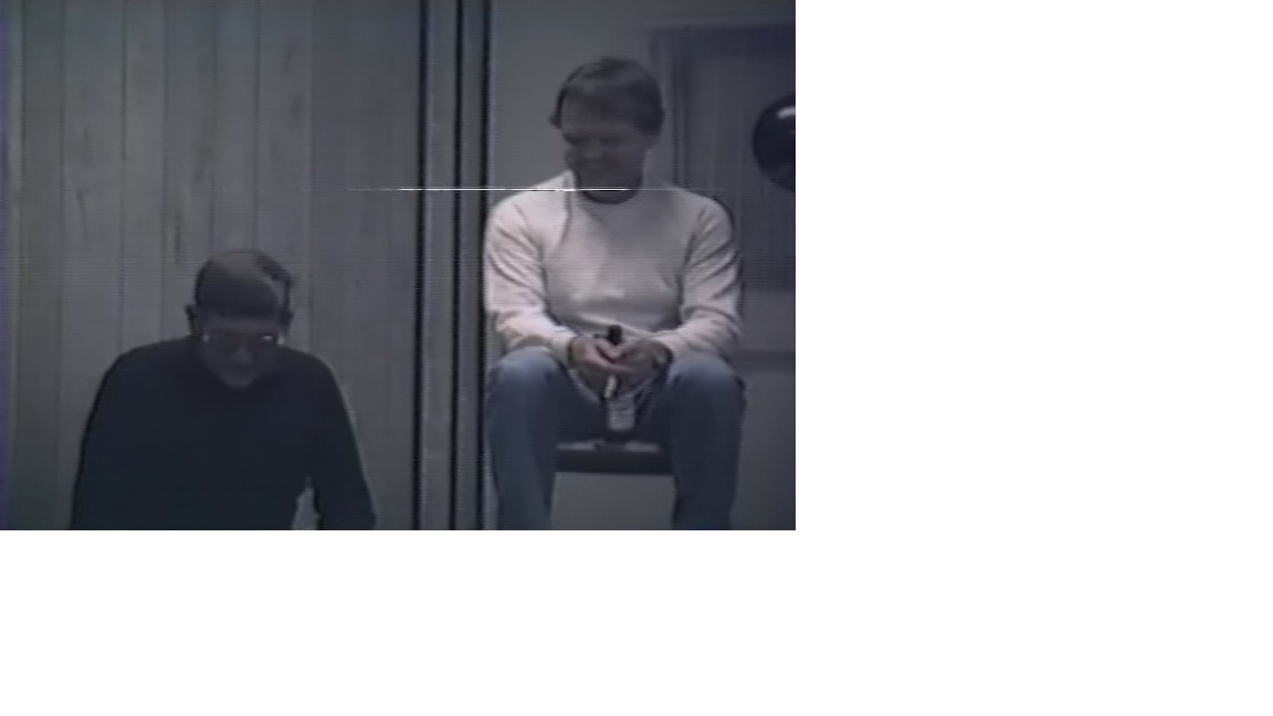

    I have some BetaMax footage that has some dropouts and white horizontal lines. I have never obtained any good results using avisynth scripts and I would say that is due to my limited skills with it.
    Can someone give me a script that would work with lines like the picture below?

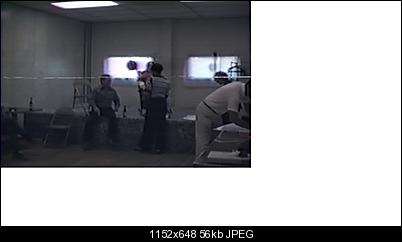

  2. Member LSchafroth's Avatar
    Dec 2002
    this would be another type in the video, not as wide as the previous one:
    Turning the video sideways and running Descratch may have some affects on it.
    I've not tested.
    Is this interlaced video you have? Interlaced video is always hard to work with, for this error.
  4. What have you tried so far ?
    RemoveDirtMC or RemoveDust should be able to take care of the smaller dropouts in the 2nd screenshot. Use lower settings first and work your way up (they are all damaging to some extent, but if you use too weak settings, they will miss detection and repair of more errors).
    It is possible to preserve interlacing if you apply to even/odd fields. Sometimes you get synergistic results with stacking filters and/or multiple passes (i.e run a weak pass first, then apply the other filters)
    Maybe if you posted a video sample others would have better suggestions or more precise settings to use

    I can make a short sample of the video. I am going to deinterlace it anyway so I should do that before the other filters? I have tried the turnleft in avisynth with despot and descratch with no results at all. They dont do anything. I will look at removeDirtMC and RemoveDust.
    When I watch the video on my 46" flatscreen it looks jerky or ghosted when doign panning motion left and right. I thought it was a field order issue but changing it makes no difference. I encoded it with a 100% quality CQ with no difference. I did the virtualdub yadi deinterlace picking bottom field since it is DV footage and the ghosting goes away.
    The tapes were pretty bad shape. The strange thing that fixed them to the point og being able to capture was dropping the tape on a flat surface a few times, then fast forwarding and rewinding a few times. Then it played much better. Did it 4 times in teh same manner and teh playability was terrific compared to before. Now I'm just left with dropouts. The other tapes played really great for being 28 years old!

  7. Originally Posted by LSchafroth View Post
    After hours of trying avisynth scripts I gave up and put them to DVD with the dropouts. The filters seem to be pretty worthless.
    Lannie
    You're joking right?
    They work really well on that 2nd type of artifact , and possibly even the 1st if you set the strength high
    The only situation that the MC variant doesn't work well, is if you have a persistent defect (ie. the scratches occur on consecutive frames in the exact same location, or you have dupe frames)
    Post an unprocessed video sample

  10. Member LSchafroth's Avatar
    Dec 2002
    Lannie
    Thats why I posted it here as the filters dont appear to do anything. I have searched many other forums and they all seem to get the same results. nothing.
    Lannie
