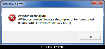

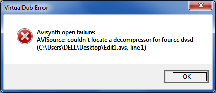

    When i'm using this AVS script source:
    AviSource("clip0.avi")
    QTGMC(preset="veryfast")
    I'm getting this error in Virtualdub when i open the AVS file:

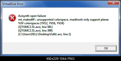

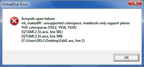

    DirectShowSource("clip0.avi")
    Jul 2009
    Spain
    Install the Cedocida DV codec.
  11. Originally Posted by spycam View Post
    [Attachment 4769 - Click to enlarge]
    Add ConvertToYV12():
    ConvertToYV12(interlaced=true)
    In general, I recommend using AviSource() instead of DirectShowSource(). The latter is dependent on what DirectShow filters you have installed and isn't always frame accurate. It's probably OK for a DV AVI though.
