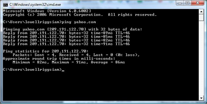

    The first thing I'd try to do is reboot the router. Afterwards try to connnect via wireless. When the laptop says it's connected start -> CMD then
