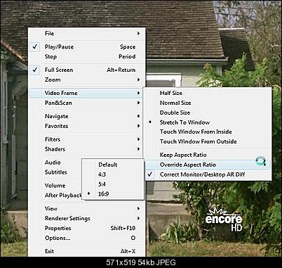

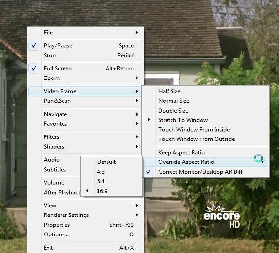

    MPCHC has several aspect ratio controls. Here is how I did it from the normal play window (right click).
    First I changed VGA resolution from 1366x768 to 1024x768 to simulate your situation. Then I used these settings to stretch the image to fit the HDTV screen. You can also play with "Override Aspect Ratio". The MPC-HC window is in "Full Screen" mode.

  15. Thanks a lot!
    I set 'Override Aspect Ratio' to 4:3 and TV to 16:9 and it works like a charm.
