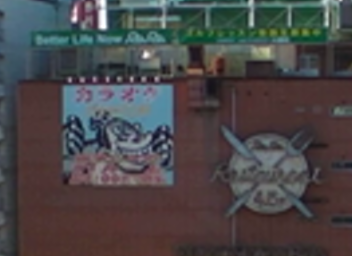

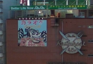

  3. Is your source interlaced or progressive? In any case, small text will definitely get blurry when reducing the frame size from HD to SD resolutions. You should also stick with frame sizes that are a multiple of 16 or 8. For example, 720x400.
    A crop of small text from a 1920x1080 video file:

    After reducing to 720x400 it's no longer readable:

    Even if you enlarge it back to the same size:
