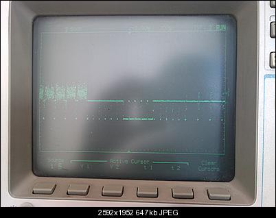

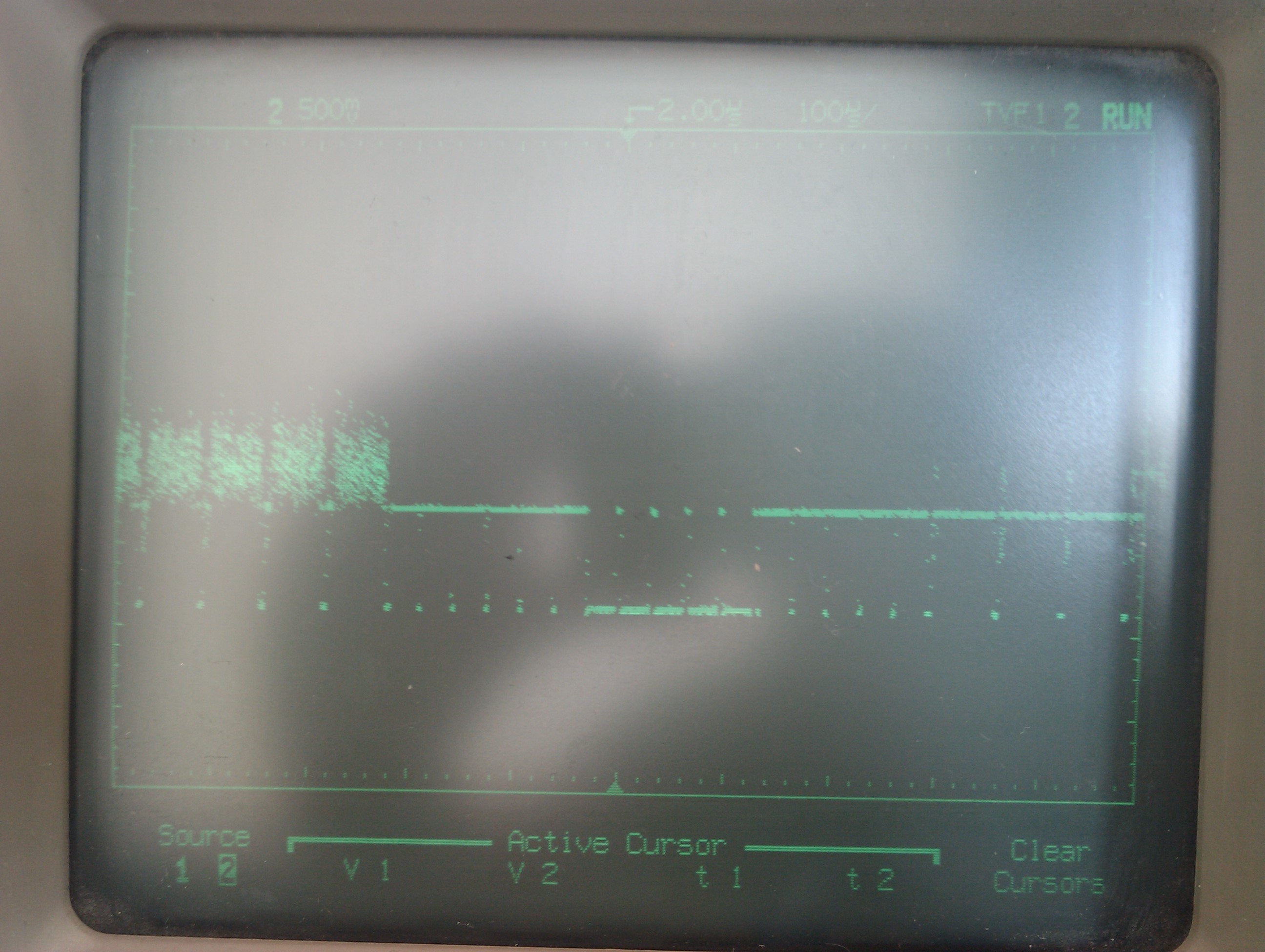

On some tv's, the sync seems to be off, resulting in a rolling picture.

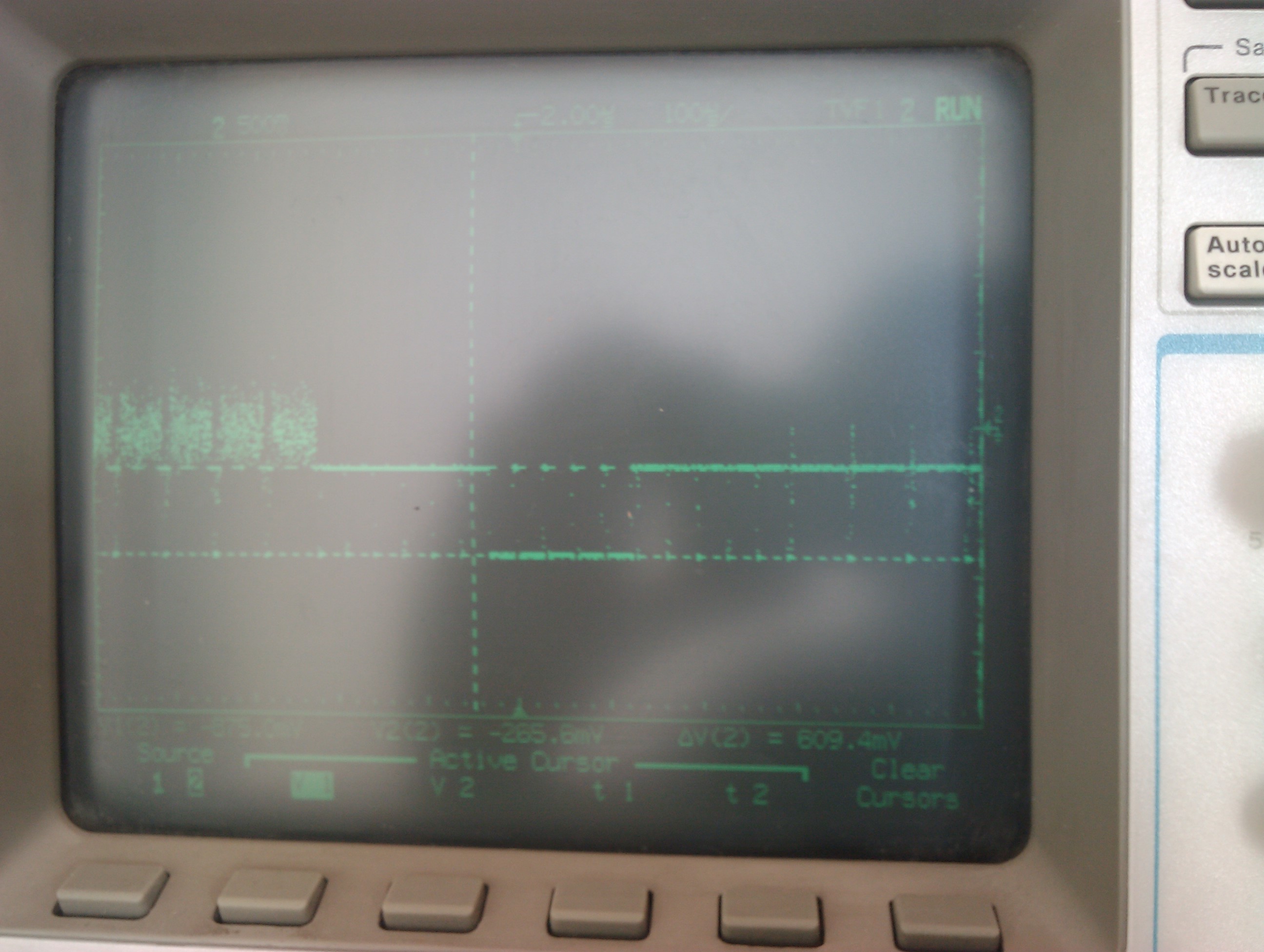

I've hooked up the oscilloscope to the composite video output to do some readings, and there i stumbled upon something strange.
The signal looks ok (not scrambled) however, when measuring peaks, i get a Vp-p varying from 1,3V all the way through 2,1v.
If i hook the oscilloscope up to a different random VCR here, the readings seem far more normal (I was tought that composite signals have 0v - 0,3v sync and 0,3v to 1,0v of further picture information, giving a Vp-p of around 1,0V)
Now i suspect that's the cause of the problem.
I see the sync signal has a DeltaV of ~609mV , which is around double what i had expected.
Do my findings seem correct? (Roughly i suspect that the output signal is twice as strong as it should be, possibly causing the issue on -some- TV's, my test-setup tv does not have any sync issue.) And does someone perhaps have an idea what may cause this problem?
I might be far off, that's possible, my expertise really isn't in video signals, that's why i'm visiting you
Pictures of oscilloscope readings are attatched too! (HP 54600A used)
