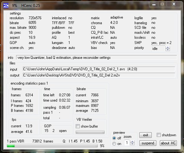

    Hi, while using AVStoDVD to make a DVD out of .avi-files I get this error message from HCenc 0.25:
    very low Qantizer, bad Q estimation, please reconsider settings
    What is Quantizer? And where and by what criteria do I set it?
    Thank you.

  2. Quantization is basically a smart mpeg2/4 encoding strategy to allocate bitrate where it is more needed.
    HCenc works using quantization factors. Release 0.24 has introduced the possibility to perform 1-pass VBR encoding, having a quick first predictive step and then the effective encoding pass. If the prediction step gives a low quantization factor (probably due to a high target bitrate), the HCenc will throw out a warning message. For target bitrates less then 6500 kbps, just ignore it (that's my experience).
    Bye
    MrC
    AVStoDVD Homepage
  3. Yeah, the bitrate is way too high for the other settings and you probably won't be able to achieve the size you want. I think you can probably get rid of the message by switching to a high-bitrate quantization matrix, one such as the included Fox Home Entertainment (aka Fox 1) Matrix.

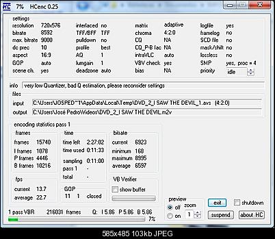

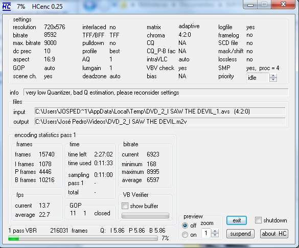

    I have the same message as VenusAndMars and it wouldn't be a problem if the resulting video wouldn't had a sort of fading effect present, like a subtle ghost. I changend the matrix to Fox 1 as Manono suggested, yet, the message persists. I don't know if somehow the resulting video will have the same problem or if there is indeed a conection between the message and the sort of ghostly image. I have to wait for the the result of the edition

  8. Originally Posted by Ze Tomes View Post
    Greetings, and special Greetings MrC. It's been a long time
    I have the same message as VenusAndMars and it wouldn't be a problem if the resulting video wouldn't had a sort of fading effect present, like a subtle...etc.
    [Attachment 12754 - Click to enlarge]
    Great input Ze Tomes; the quest goes on!
  9. The result was identical to the first test, the message keeps apearing. I don't know if it's my interpretation, because everything's almost flawless in the edited video, except for the very subtle shading effect on movement specially on 3/4, medium and close-up shots. Could it be the source video or another encoder I should use?
    true cyber-democracy lies in forums
    some sketches at flickr, tacting ideas at my blog
  10. Do not mind: HCenc is designed to work best with low bitrates (that, as rule of thumb, correspond to high quantizer values) so it complains if the predicted q value is low, so that the encoding is becoming more CBR than VBR. BTW the output is usually very good indeed. Simply ignore that warning message.
    Bye
    MrC
    AVStoDVD Homepage
  11. Originally Posted by Ze Tomes View Post
    Could it be the source video...?
    You can't tell? You don't know how to examine the frames yourself? If not, upload a 10 second piece from the source either here, Sendspace, or MediaFire, a section with steady movement, and we'll have a look. Maybe it's field-blended or has some other peculiarity that prevents it from looking good without some special filtering.
