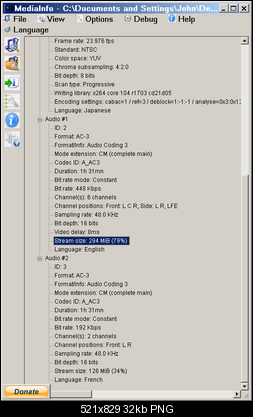

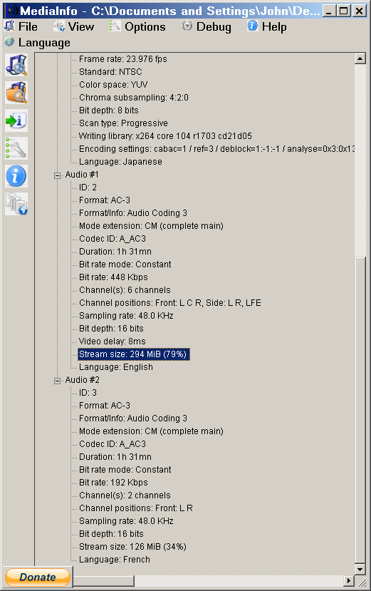

  8. I applied language tags to the video and audio streams and MediaInfo shows them all:

    Yes, I've noticed that recent MediaInfo (i.e. latest 07.37) will show Language tag for video/audio even if tags aren't defined (I can only speculate why's that).
    Open MKVtoolnix (latest v4.40) and use menu File-Header editor (or use mkvinfo.exe directly). Now check for language tags again and you'll see, tags aren't defined.

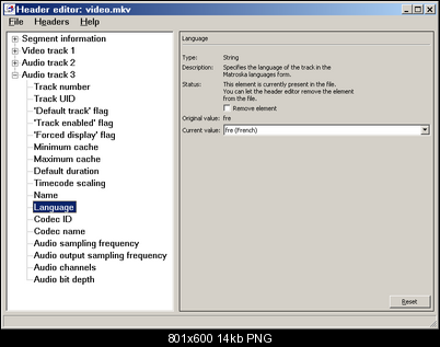

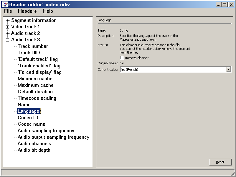

  10. The languages show up in the header editor when I use it:
