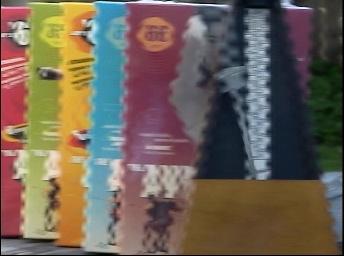

    Did your "waves" look something like this:
  11. jagabo: I'm (slowly) digesting your post, and I will try the script you suggested as soon as I'm done testing the AutoGK method manono suggested (running now). I think I follow on the index file, so I'll go that route as well.
    The waves sort of look like that. They're definitely not as pronounced... in fact, I think I may have mis-characterized the waves altogether. It's almost like looking through warped glass that you're tilting up and down, where some of the screen looks fine and other parts do not. Almost as if some parts of the screen are jumping up and down at seemingly random times. It's a little disconcerting. Hopefully this describes the effect better.
