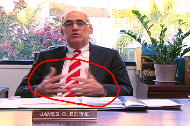

  9. I think you can change the player in the blip dashboard settings. Right now you are using default basic player, so the blip logo is there
    Also, there are some paid features too if you want to upgrade, I can't recall what benefits you get
    You have 2 videos playing simultaneously, maybe that's why it's buffering - the keyed out girl ,and the guy setting behind the desk
    Your aspect ratio is off for a 16:9 video. It's 640x426 which is ~1.5 AR . That's why you get pillarboxing. You would use something like 640x360 for 16:9 . Or something like 848x480
    It's not optimized very well for streaming. It's a bit noisy and you left it interlaced. You should pre-process it with mild denoising filters and deinterlace properly. Right now you are using ~2.5Mb/s which is what youtube uses for 720p. You could increase the subjective quality and reduce the bandwidth streaming by denoising , deinterlacing, and using better encoding settings. You shouldn't need that much bitrate if you optimized it correctly. An interview has very little motion and should compress well. This will help with buffering if you reduce bandwidth requirements
