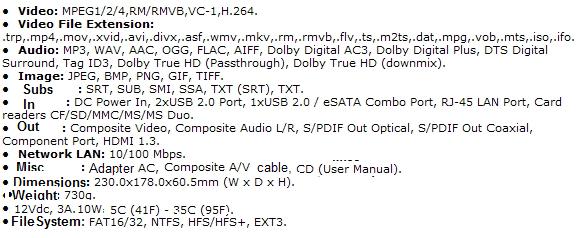

  1. I am thinking to get one to put all my dvd's and downloaded videos.
    I am looking at:
    ASUS O!PLAY HD2
    http://www.trustedreviews.com/multimedia/review/2010/09/29/Asus-O-Play-HD2/p3
    With a Western Digital WD20EVDS 2TB AV-GP SATA2 disk.
    A bit bulky and ugly, but I think its features are good.
    What do you think?
