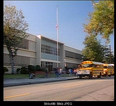

    This is a frame snapshot from VDub:

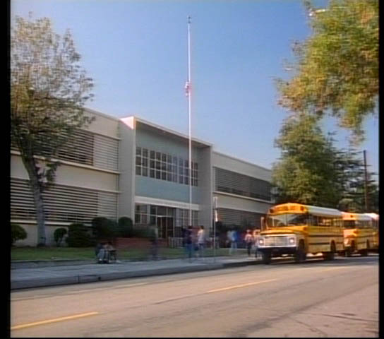

    And this is what it should look like by cropping and resizing to 4:3 in Photoshop
