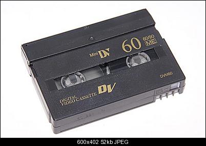

  12. Member Cornucopia's Avatar
    Maybe you don't realize it, but the term "Camcorder Video Tapes" could refer easily to 10 or more consumer formats and/or a greater number of Pro formats.
    But I'm going to go out on a limb and ask, do the tapes look like this?
    If so, you are talking about Digital Video (aka DV, miniDV). The good news for that would be that you could transfer the file digitally to Hard drive, which would be directly usable as 16bit,48kHz Stereo LPCM (like WAV) file, which can be directly authored onto a DVD without ANY conversion (aka NO LOSS). You'd just need to borrow/rent a camcorder (and PC with Firewire port if you didn't have one), or you could get them simply transferred at a pro dub house or production company ( or maybe even somebody on this forum), leaving you with files on a hard drive.
    Unless the camcorder did a bad job of recording the material, you might not even need to NORMALIZE/gain change.

    Oct 2010
    Hi Scott!
    Thanks for getting back to me so soon. I went looking for the original Camcorder tapes this morning but haven't located them as yet. As I recall, they do look similar to the example that you sent (thanks for the extra effort) and are about 5 inches in length, I believe. Maybe 3 inches in width? They aren't black though...clear...I believe. It's been awhile since I've seen them, but I know I still have them.
    So, I could rent a camcorder and the other equipment necessary? Good. I do have a Mac and a Firewire cable and port already. I no longer own a PC. Hmm...a pro dub house. The one I originally took the tapes to in order to have them converted to DVD, somehow, ruined one of my best arias by leaving a gap in the last long and beautiful note that I was singing. I was aghast, when I saw it in the Audacity waveform. I tried to "close" it.. but to no avail. I ended up using the VHS taped version on the CD because the original Camcorder and VHS tapes do not have that gap.
    If I can do what you suggested, then I'd have the original source audio and could use that particular "ruined" aria as well. This taped version I was forced to use on the CD, sounds less "clean" than the other songs simply because it was ripped from an audio cassette tape instead of the DVD.
    Do you think that the Geek Squad at Best Buy might be able to help me with a Camcorder, etc? I've never rented anything like that before, but they must have rental places that offer that sort of thing, I'm sure?
    I know what you mean by possibly not using "Normalize" on these songs. I've often wondered if I should have simply left that step out altogether... since the songs sounded so "clean" to me before I began to edit them in Audacity. Hey, I'm new at all this folks...but I'm learning! LOL. You guys are the experts....and I fully appreciate your expertise!
    Wish me luck!
    Happy New Year!!
    MLK3329
