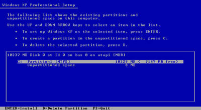

    OK, tried to repair install, still freezes did not change anything. So I was going to try to do a total reinstall with the XP CD and it asks we in what partition. It says set up Windows XP on select item, create a partition in the unpartitioned space or delete the selected partition.
    it has C: Partition1 (NTFS) 152617 MD (79500) free
    or unpartitioned space 8MB.....what do I do?
  19. Banned
    Freedonia
    Choose "set up Windows XP on select item" and pray that it's not destructive. It shouldn't be, but again this is Windows so it's unfortunately possible.
    If there is anything on the disk drive that you cannot live without if it was wiped, you need to get help getting that off the drive before you try this. If you don't have PC guru friends who can help you then you'll need to pay someone like the Geek Squad to get stuff off the drive for you.

    You would want to use the larger partition C: to install. The drivers disc is for the model Dell it came with to install the hardware drivers after the XP is loaded.

    Delete the primary partition, after which it will reformat cleaning your hard drive.

    ok, I deleted that partion and reinstalled xp, then loaded my device/drivers cd and loaded in order listed on Dells website for my computer the vostro 1500 with windows XP. Everything seems to be working perfect except for my ability to scroll down. It is very slow to scroll up or down. Pages load quickly as well as programs. Any more ideas. You guys have been a huge help. Thanks for all the infor you've already given me!
