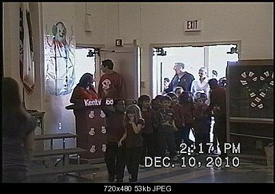

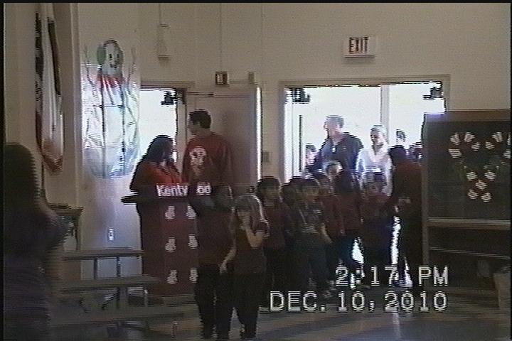

    Ffdshow doesn't seem to have it, but many MJPEG decoders have a "field swap" option (this is not a field order option). If you are using one of those make sure you don't have the feature enabled. It will turn this:
    into this:

  7. When I view your two clips on my computer they are the same (in terms of field order and field placement). I can create the problem you seem to be seeing by switching the location of the top and bottom fields (the sample image I posted).
    If you are having that problem all you need to do is use the field swap option of the decoder while editing (VirtualDub also has a filter that does it -- field swap). The problem I foresee is that, if you have one MJPEG video with the problem and anotherMJPEG video without it, you can't edit them at the same time -- one or the other will always be wrong (because the same MJPEG decoder will be used by both). You'll have to convert one of the videos before you can edit the two together.
