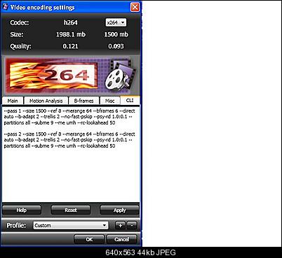

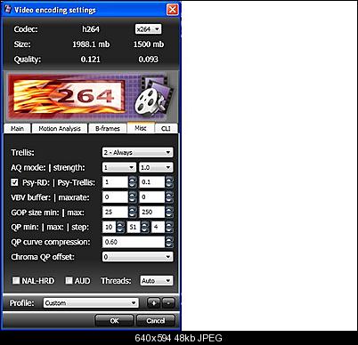

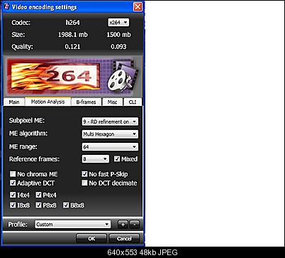

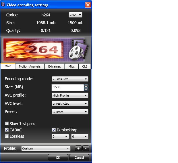

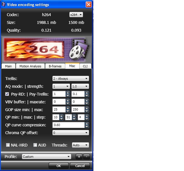

    Hi guys,
    I usually downsize videos using x264 encoders.i use two pass encoding which is is done with xvid4psp. but it is taking a lot of time.These are the settings i generally use .is it because of the settings i use or is it just the x264 encoder is slow by nature.i would like to get settings which will provide maximum quality with minimum time consumed

    settings used-reduce reference frames and bframes to 3, and reduce subme to 7- should reduce encoding time substantially with negligible effect on quality
  3. Member PuzZLeR's Avatar
    Oct 2006
    Toronto Canada
    Let me suggest you use constant quality instead of two passes. It should cut your time almost in half.
    I believe doing two passes today is a waste of time unless, and only if, a specific bitrate is desired.
    As well, I too will highly recommend you reduce bframes and reference frames to 3. Other than maybe animation, I personally have never seen a benefit to more.
    I'm also wondering what preset is default on this GUI (don't use it). x264 has 10 settings that can go from Ultra Fast to Placebo. The closer to Ultra Fast the faster the encode no doubt.

  6. You're using slow 1st pass . 1st Pass is mainly for frametype and bitrate allocation , and slow settings provide negligible benefit and make it waaay slower.
    ME Range of 64 is overkill. "Placebo" settings use 24, and that is usually overkill.
    Check your encode logs to see if you actually use that many consecutive b-frames or reference frames. On those particular sources, if they are not used, you're only wasting time.
