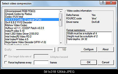

  4. Lone soldier Cauptain's Avatar
    Jan 2006
    Brazil
    Strange...Because I use K-lite Mega and my VD 32bits, work normal (look the shot)
    Reinstall your K-lite in full mode.

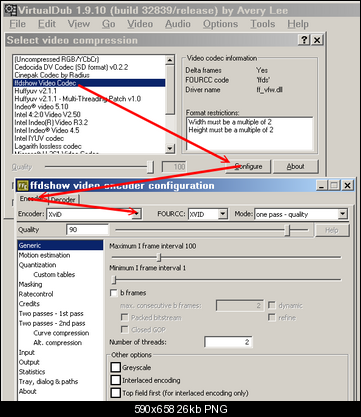

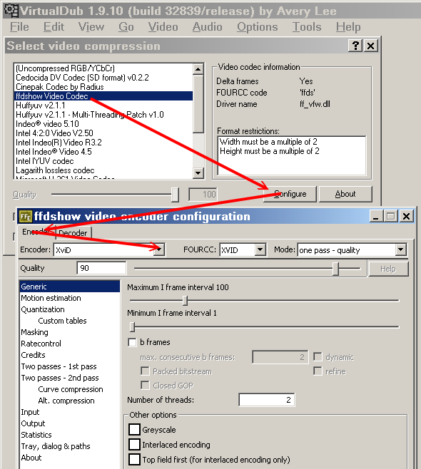

  9. Originally Posted by EdoScario90 View Post
    i already configure the VfW settings of ffdshow and, for example, there si "libavcodec" in the "divx" codec, but the codec miss in virtualdub
    You select "ffdshow Video Codec" in VirtualDub. Then press the Configure button to select which of ffdshow's codecs to use.
    [Attachment 4632 - Click to enlarge]
    it works!
