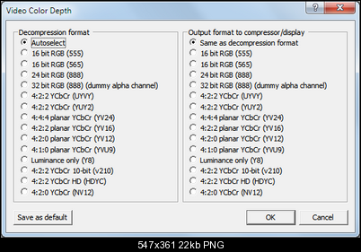

    What do you have the output colorspace set to? I have the decompression colorspace set to Autoselect and the Output format set to Same as Decompression Format:
    You can always force the output colorspace too. Actually, I usually have both set to YUY2 or YV16 (same as YUY2 except planer, not interleaved).

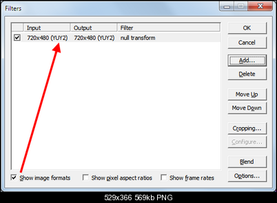

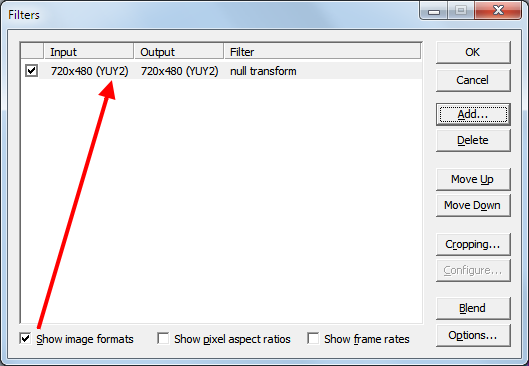

    Add the Null Transform filter and set the Filter dialog to show colorspaces. That will show you the colorspace negotiated between the decompression codec and VirtualDub:
    As you can see, it shows the colorspace before and after each filter.

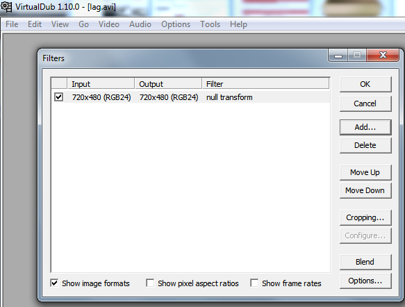

  13. This is when i have Auto and Same as, in colorspace.
  14. When you exported uncompressed what was the output colorspace setting?
  15. The settings where as your picture, and the file i saved with uncompressed got as stated RGB24
  16. What does MediaInfo say about the saved file?

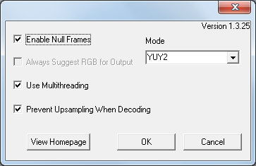

  22. I have lagarith set as follows:
    I can't play the source video with the "prevent upsampling" option enabled like this -- I get an error dialog about the video not being RGB. But I have no need to play videos while editing. I can play the output video though. Actually, I hardly ever use VirtualDub for filtering. I usually use AviSynth for that.

    Can you play Lagarith videos if you got those settings, as i canīt if i have Prevent Upsampling When Decoding on;S
  24. I already told you I can't "play" lagarith YUY2 videos if I have the "prevent upsampling..." option set. But scrubbing through the video and playing the output video work fine. That's a longstanding bug in VirtualDub.
  25. Yes but did you mean play it on Virtualdub or play the output lagarith file, as i canīt play the output lagarith file, which you could, i canīt do either.
  26. When I press the >I button (or File -> Preview Input) in VirtualDub it will not play. When I press the >O button (or File -> Preview Filtered) in VirtualDub it will play.
