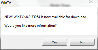

    **EDIT** -- Yikes! Looks like v8.0 is old news.
    I was having difficulty installing the latest WinTV-7 update (previous was off CD) from the Hauppauge website as it kept saying one DLL after another was running so I cleared all Haup drivers and software to perform a clean install of the latest app. Still had the DLL warnings and found it was initializing the WinTV tray apps as they were in being installed, inevitably they were running the shared DLL's. After killing those process install completed. Anyhow, the image below is the update prompt for v8.0 which I was able to generate again after this clean install.

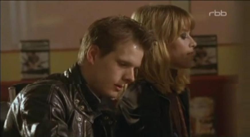

    Now I have a current concern. When recording using Colossus via HDMI served form another computer there is a fair amount of clipping during high action scenes. Seems to make no difference whether it's SD or HD content. The same capture computer, on a daily basis, has no problem using the same card capturing full HDMI via a VHD-1X2MN3D while simultaneously recording OTA full HD through an MDP-100. Activating hardware acceleration offers no improvement. I recall experiencing this many years ago while capturing with fragged HDDs but this should not be a current consideration.
    Insight appreciated.

    Test that same clip in a diff video player like VLC turn on and off deinterlace mode
    If your set top box allow for it try force in to 720p mode in the video resolution setting see if that solve your interlaced issues Golem
  27. Originally Posted by Golem View Post
    What do you mean by clipping? Is that picture supposed to show it?

    I tested the clip in WMP, VideoRedo and ZoomPlayer (deinterlace on and off), no difference.
    The "clipping" I note is only happening when recording content served from another computer. Recording content from a set-top box has always been (and still is) pristine. What I'm attempting to do is expand my Colossus capturing to include web-streaming content. As a test I played full screen in ZoomPlayer an interlaced full-HD movie and served it from one comp to the capture comp and noted the same "clipping" with and without deinterlace activated. So it seems this anomaly is not isolated to streaming content but is more a factor of comp-to-comp recording.
    @jagabo
    Not sure my terminology is correct. By clipping I'm speaking of the interlace looking line 2/3 down on the image.
    I've uploaded a sample clip that was captured from veoh.com.
    Clip - 11 Mb. / 36 sec. Sample Clip via Mediafire
  29. Originally Posted by Golem View Post
    @jagabo
    That's called tearing (as in, the image is torn). It happens when the video frame buffer is changed as a frame is being displayed. In your case, I believe the computer that is playing the video is switching frame buffers while it is still displaying the frame. So the capture device gets a frame that is part one frame of the video and part the next. Look for vertical sync options in the player and graphics card settings.
